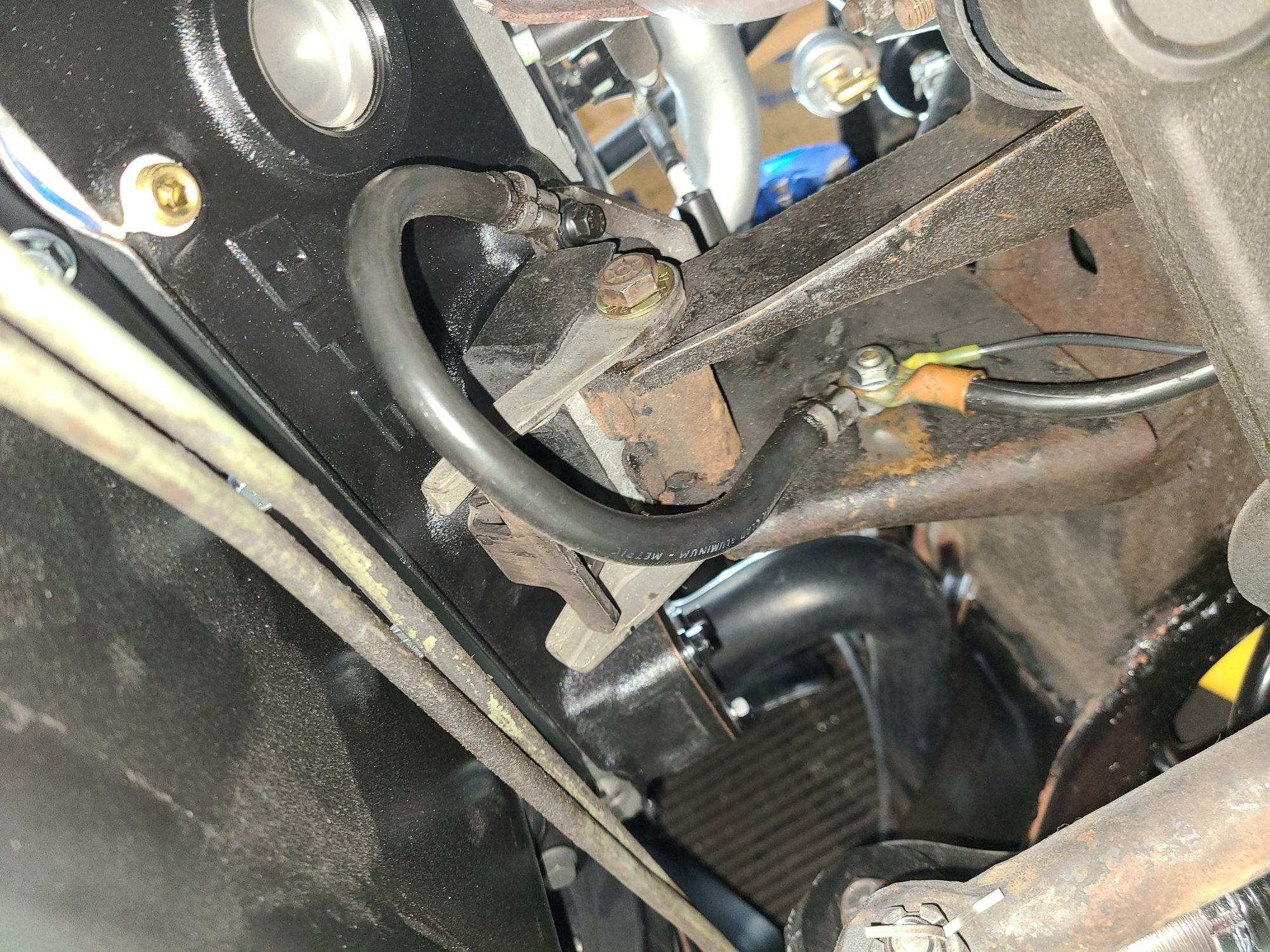

My rear ground wires and ground point. I would use a wire brush to clean any rust or dirt off and put a dab of dielectric grease on the connection.
The front ground wires and connection.
Looks for any swelling in the ground cables that would indicate corrosion inside the cable.
JT
