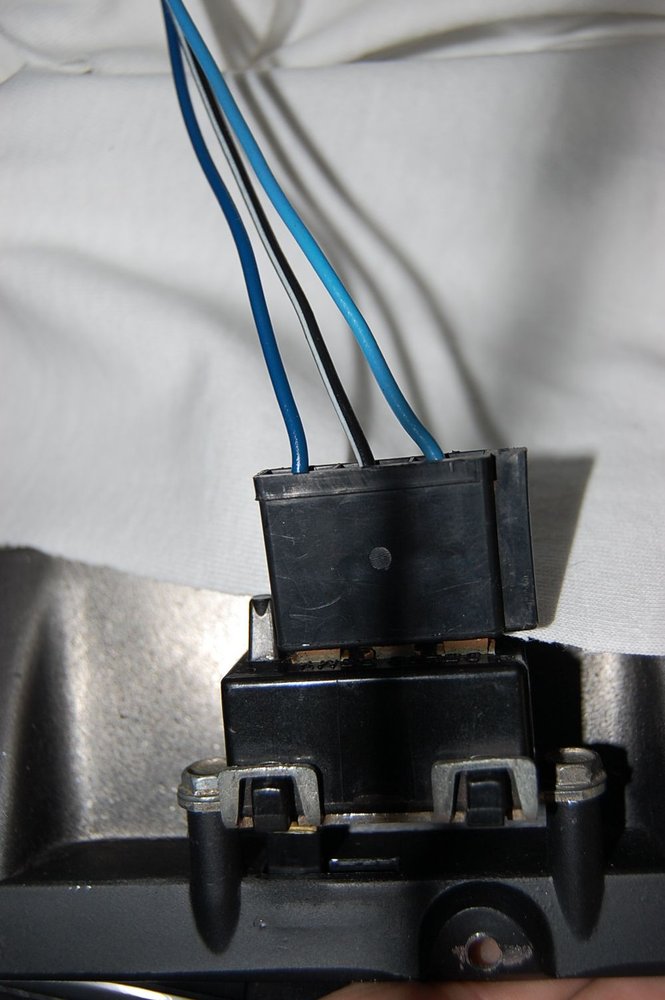

Hello,
It's quite possible to put the wiper switch connector on the switch upside down.
The small tab was added to the switch but it's still possible to make the connection upside down.
Has the connector been off lately?
Regards.....
