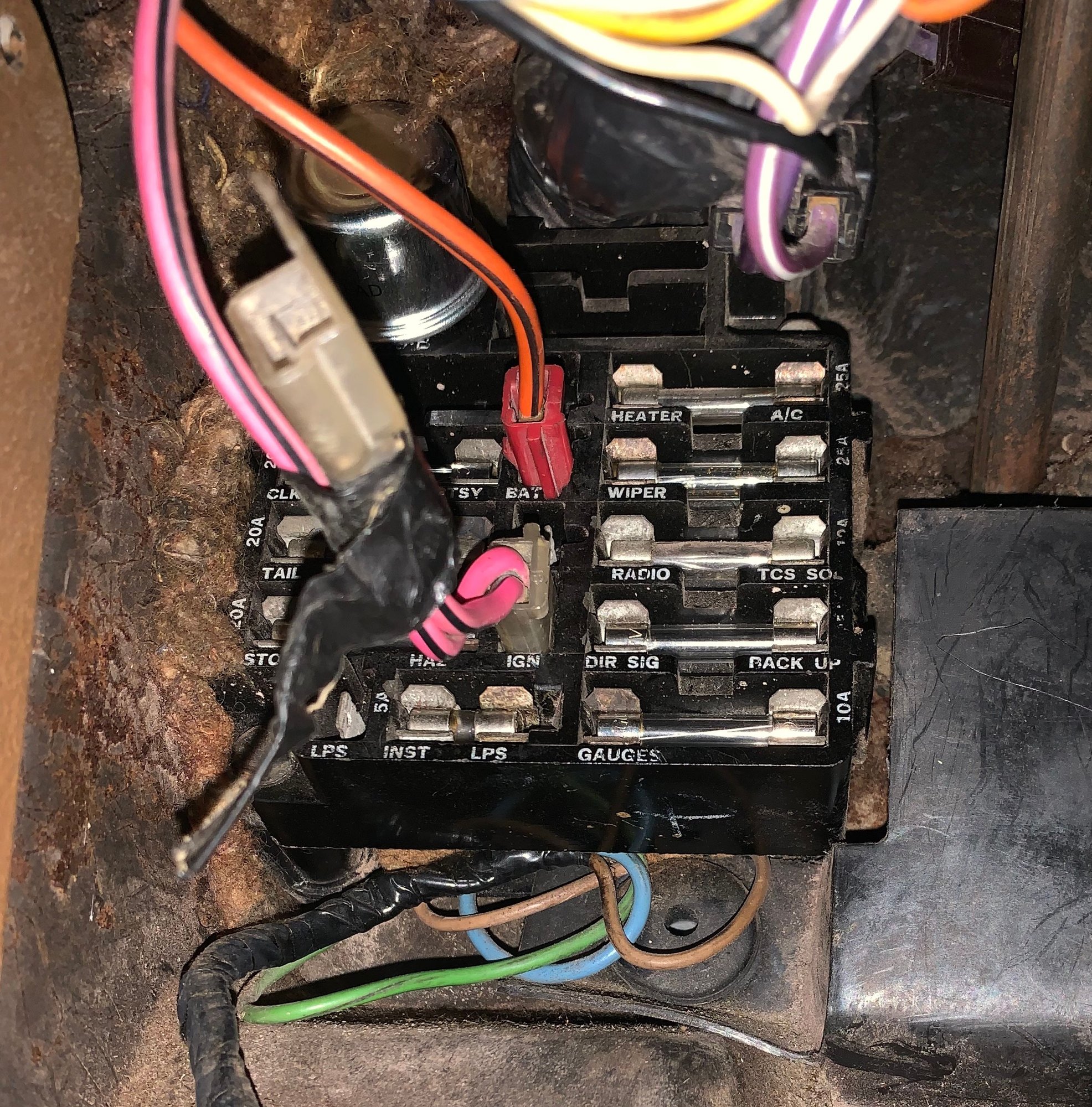

Make sure that the PINK BLACK wire is plugged into the fuse box.

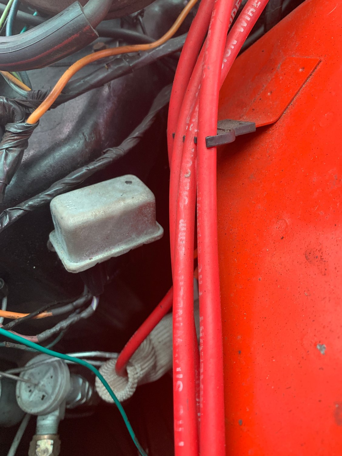

This was on the passenger side. Is this the breaker?
Followed the orange wire to the passenger side.

Pink wire is plugged in with power.

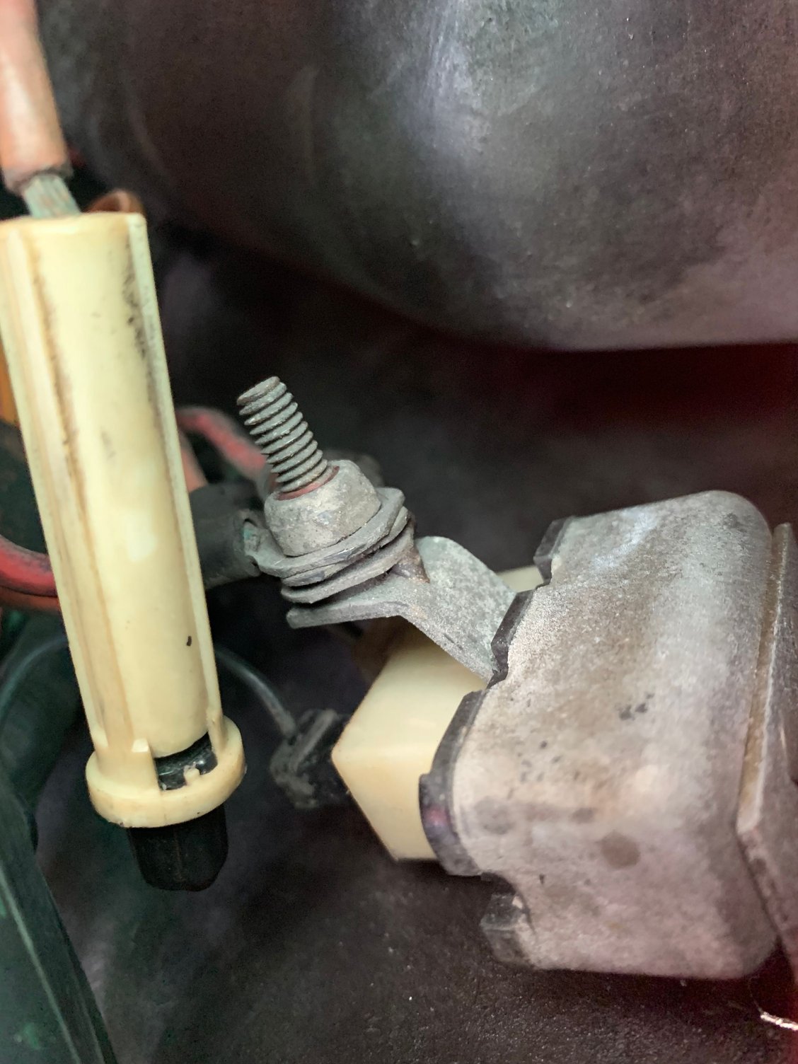

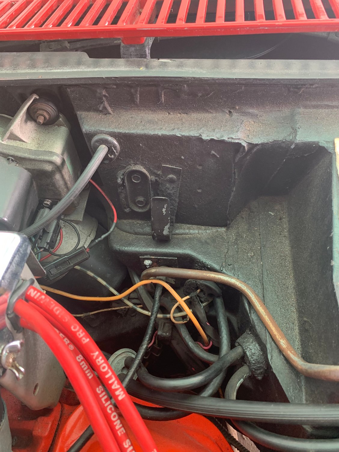

I realize that the relay isn’t the breaker after looking for a replacement part. For the life of me I can’t find it.
I found the horn relay but no CB. There is a 30a fuse with power that runs across to the earlier relay.

The relay you posted is for the heater.
Did a previous owner change the window circuit breaker and install an inline fuse instead?
A RED wire brings power INTO the circuit breaker and an ORANGE wire brings power out of the circuit breaker.
Is the inline fuse good?
Many time when both windows don't work it is because the window RELAY (under the console) is bad.
