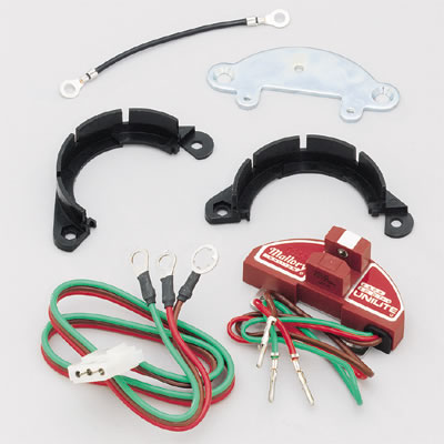

I suggest the Mallory Unilite conversion kit. Summit has them for $99.95. I installed one on my old 72 Malibu back in the eighties, worked flawlessy, never had a bit of trouble with it. Moved it to a 71 Malibu that replaced the 72, and it was still working fine, when I finally sold that car a couple of years ago.
"This kit can drive both OEM and high performance ignition coils and is designed for 1957-74 single and dual point GM Delco distributors."
Installing a Unilite conversion is one of the first things I plan to do to the new 71 vert, when it gets here.

I suggest the Mallory Unilite conversion kit. Summit has them for $99.95. ...
Mike
:iagree: :yesnod: That was done when PO still had it, zero problems since! Since I prefer Mallory over MSD anyway, it was a good match!

Alright how about this one?
Convert to a more accurate spark.
GM: 1957-74, single and dual point GM Delco distributors, Unilite breakerless ignition conversion kit
Convert your OEM style breaker points and condenser to the more reliable Unilite ignition from Mallory. This self-contained unit has no moving parts to wear out, so it provides many years of trouble free service. Simply replace the stock points with the Unilite module which consists of a photo coupler, signal processor, and power switch. Each time the shutter wheel stops the infrared light from reaching the photo coupler, the electronic circuitry energizes the ignition coil. When the shutter wheel allows the light to reach the photo coupler, the stored energy in the coil discharges. This kit can drive both OEM and high performance ignition coils and is designed for 1957-74 single and dual point GM Delco distributors.
