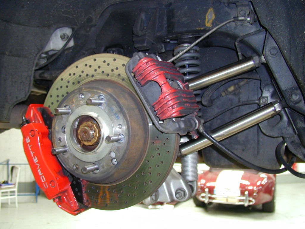

Here's a 4 link installed in a C3
And some more:

That's not a 4 link in a C3, it's a C4 with heim ended rods for the dog bones, brembo calipers and coil overs.

What's up with the dual calipers? Or is this some kind of demo?

I've seen that before and never understood either... just for more braking power? Not really the best way to go about that. Or is it for use as a parking brake?

The smaller one on the right looks like a parking brake but then again....?

read what I wrote above, it is NOT a C3, it's a C4. The brembo caliper takes care of the braking but since the late C4s have the parking brake as part of the original calipers you must retain them. The early ones had a drum style setup like we do. So, the brembo caliper in that pic is for braking and the other one is the parking brake now.
