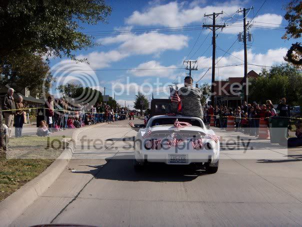

I got mine through "Wilcox" and they have a good description of the mounting needs ect.. I don't have any pins and can't see where they would help.. I did "bypass" the buckle because when tight enough to hold it was TOO tight to loosen !!! Had "velcro" added full length of the overlapping strap and now can get gas with out using tools and bad words !!!

My first few times I added bungee cords,front to rear... You can easily see the tops tabs going through the slots in the brackets while driving.... If they are not moving the tops aren't moving.... I "hear" there is no movement up to 100 mph... I do check the tightness / security of the strap at stops but after two years have yet to find any slipage. The "hooks" on the outboard sides is very well made to conform to the tops outer edges...I did make sure the brackets are as far forward as possible. They are tucked as close to the halo overhang as the rack allows which might keep air from getting under their leading adges also....I also made marks with a Sharpie on the tops edges so I'm getting the strap in the same place everytime.
