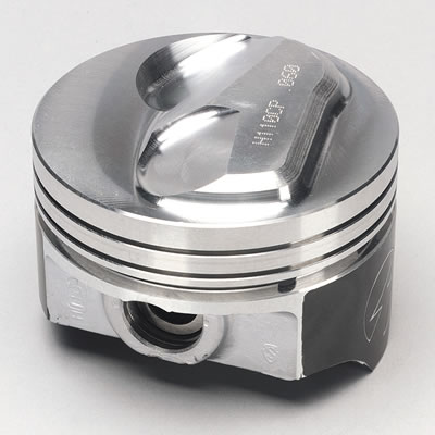

Not to hijack the thread...but I had to look them up! Check this out for 0.030 overbore pistons:
STL-H110CP30
$39.69
Dominating the horsepower-per-dollar race.
Piston, Hypereutectic, 4.280 in. Bore, 2-1/16, 1-3/16 Rings, .340 in. Dome, Each
If you're looking for pistons with an unbeatable combination of performance and value, Speed-Pro hypereutectic pistons are for you. These pistons are manufactured from FM244 aluminum alloy, which contains 16 percent silicon for greater strength and wear resistance. They're also molded in the latest permanent-mold technology to ensure the precise fit and tight bore clearances that today's top engine builders demand. They're ideal for use in high-performance street, bracket racing, and Oval Track, and will work perfectly with normal ring end gaps.
Vendor Speed Pro
Product Line Speed-Pro Hypereutectic Pistons
Bore (in) 4.280
Bore (mm) (Not Specified)
Piston Material Hypereutectic aluminum
Piston Style Dome
Compression Distance (in) 1.640
Dome Height (in) 0.340
Dome Volume (cc) 33.00
Dish Volume (cc) (Not Specified)
Valve Reliefs Two
Wrist Pin Style Press fit or floating
Pin Diameter (in) 0.989
Top Ring Thickness 1/16 in.
Second Ring Thickness 1/16 in.
Oil Ring Thickness 3/16 in.
Quantity Sold individually.
Notes Piston has coated skirt.
Check out that dome height! The photo:
http://store.summitracing.com/defaul...+454&x=18&y=12
shows a serious dome! Wonder what that would do with my 119cc open chamber heads? The 33cc domes would give just a bit more than the approximate CR as the taller dome piston found on the 1970 LS-6 and discussed above. Any possible valve clearance issues? They show this piston for Gen IV, V and VI fitments and a set is about $80 cheaper than forged...
They also list a 0.060 piston with a 0.300 dome height and dome volume of 30.00cc
See also part number STL-H426CP for a standard bore (4.250) piston with only a 0.100 dome. Dome Volume (cc) 10.50. A 0.020 overbore piston is part number STL-H426CP20 and a 0.030 overbore is STL-H426CP30 both for $26.69 apiece!

I got no picture with that link....just a Summit page??
Old Nov 29, 2004 | 04:48 PM
djcwardog's Avatar
djcwardog
Joined: Apr 2003
Posts: 844
From: Central KY
Jughead,
Its possessed! No matter what it defaults to the basic screen. Input the part number in a search and it should come up that way... Go figure! Sorry about that...
