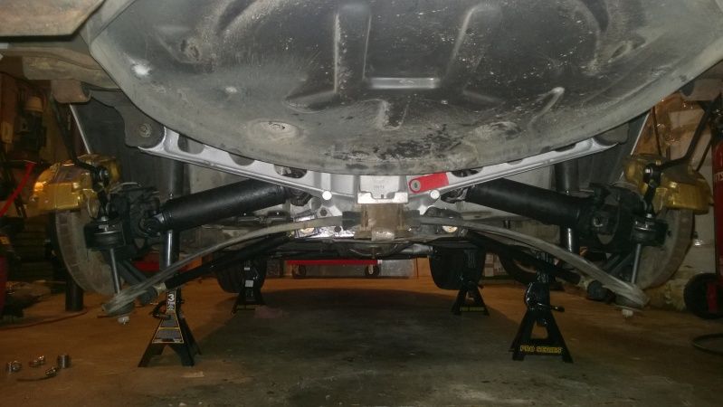

raising the nut raises the car, bringing it down lowers it. Here's were my 8'' long bolt nuts are:
To Lowering a C3
