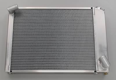

From what I heard, if you have a filler neck on your radiator, then you should not have an expansion tank. I switched my radiator from on without the filler neck to one with and Tom Dewitt, a member here who owns, DeWitt radiators, told me to ditch the expansion tank.
Thanks,
Joe

Here is the radiator I installed.
Thanks,
Joe

IN 68, THE BIG BLOCK DID NOT HAVE A TANK, WHILE THE SMALL BLOCK DID!!
If you don't use one, you can't fill up the system all the way because the coolant expands as it heats up. Simply leave a little out or fill it all the way and leave the cap off while you run the engine up to operating temp and catch the runoff in a bucket, then cap it once it cools back down. The tank simply holds that expanded coolant. Either is fine, but what's PROPER is in my first sentance.
