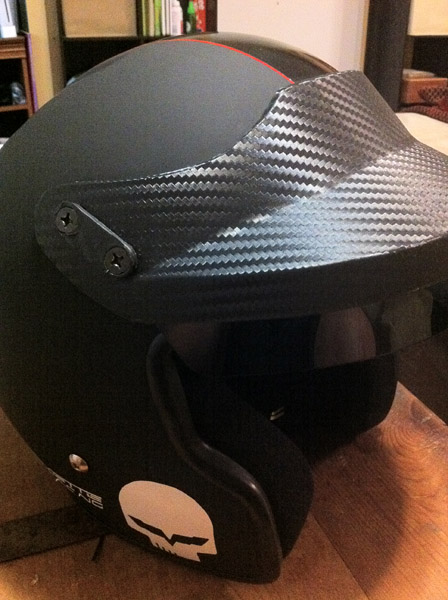

Yeah, a plain ole hair dryer works great! Certainly watch the youtube vids. I didn't until AFTER I installed it on my roof and halo. Recently did the visor on my autocross helmet and it came out fantastic!

I didn't remove the trim piece at all. I got a small tube of adhesive promotor to put on the corners of the top, that's it. The 3M di-noc has adhesive backing like normal vinyl. You just place the adhesive promotor in the corners, and it doesn't take much at all, lay down the vinyl, heat to stretch to fit the curves, then cut the access off with a fresh xacto-blade. Search youtube for how-to videos. It's pretty easy once you figure it out. A 48x48 should be plenty big enough, you only need a few inches of extra. I got a 48x72 to fit the halo as well and have a TON of left over scrap. I used the scrap to cover the door handles and the window attachment covers on the rear glass. I'll also have enough to do the side mirrors.
I used my helmet to do some more training before I do my hood...and probably the rest of the car.
