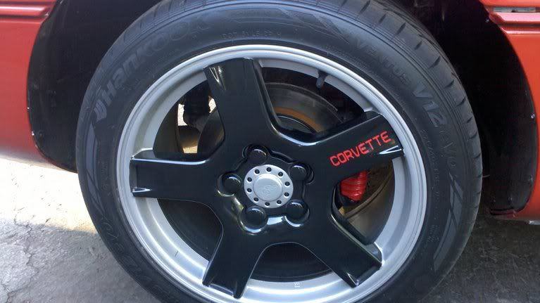

my 85
Old Sep 1, 2014 | 03:22 PM
redvetttes's Avatar
redvetttes
Joined: Dec 2010
Posts: 234
powder coated they look ok

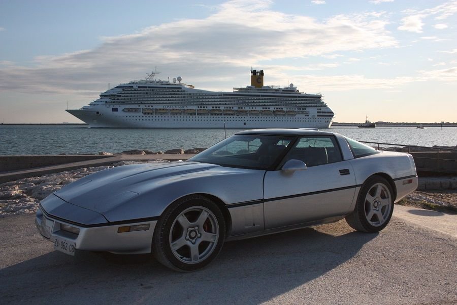

Bought them for my 85 with decent tires for $150, in my eyes much better than salad shooters.

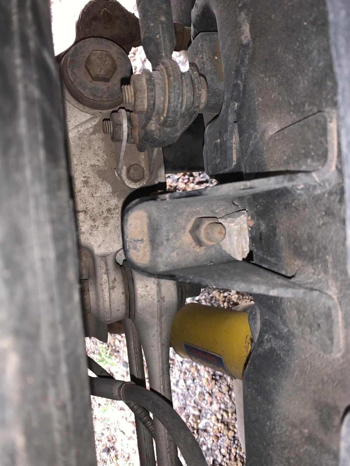

So I just tried putting the rear c5 wagon wheels on my 85 vette and they’re rubbing on a bolt on the inside of the tires. Now I know for sure they need adapters. I need help with the size of spacers I need to get. The front wheels went on just fine.
Do they have a shock bolt on BACKWARD
The nuts should on the inside

Default This is what is doing it.
This is what is rubbing on the inside of the tire.

can you flip the bolts around ?

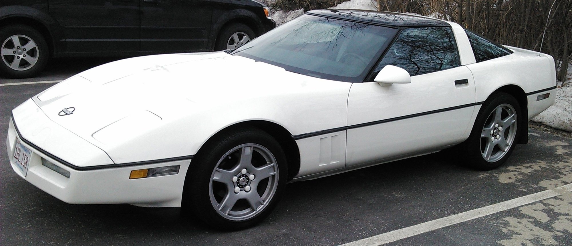

They will bolt right up, here they are on my wife's 1986
NO SPACERS AT ALL, one less thing to come loose and fall off

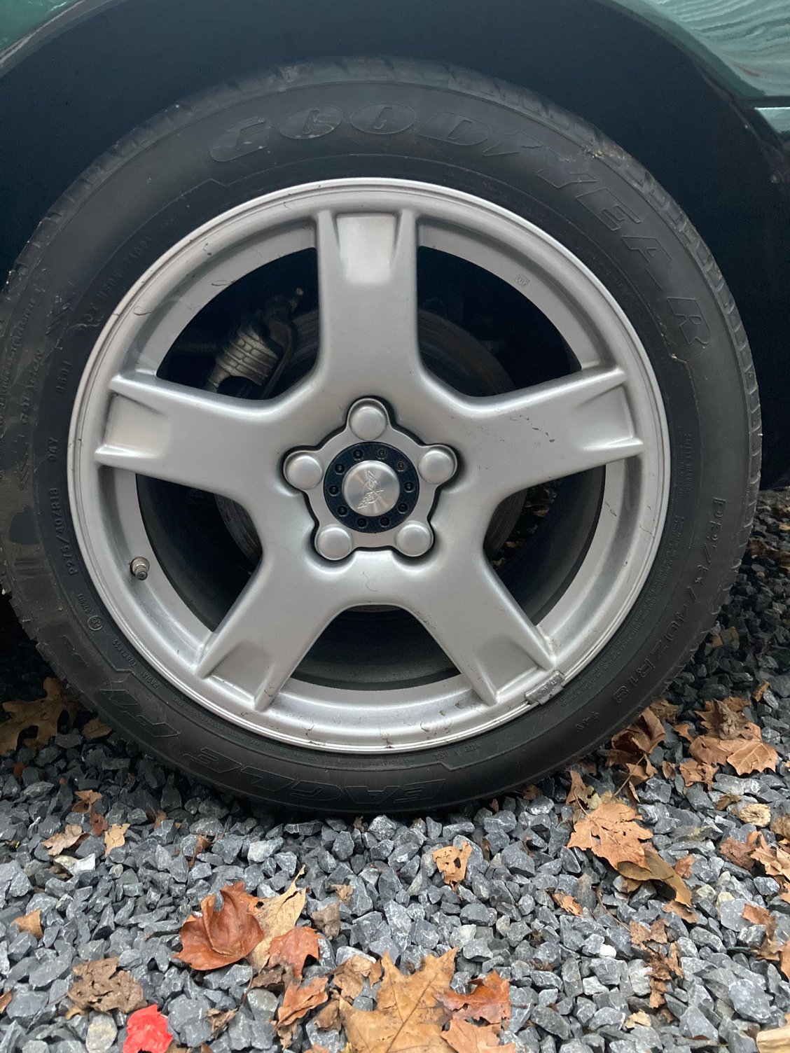

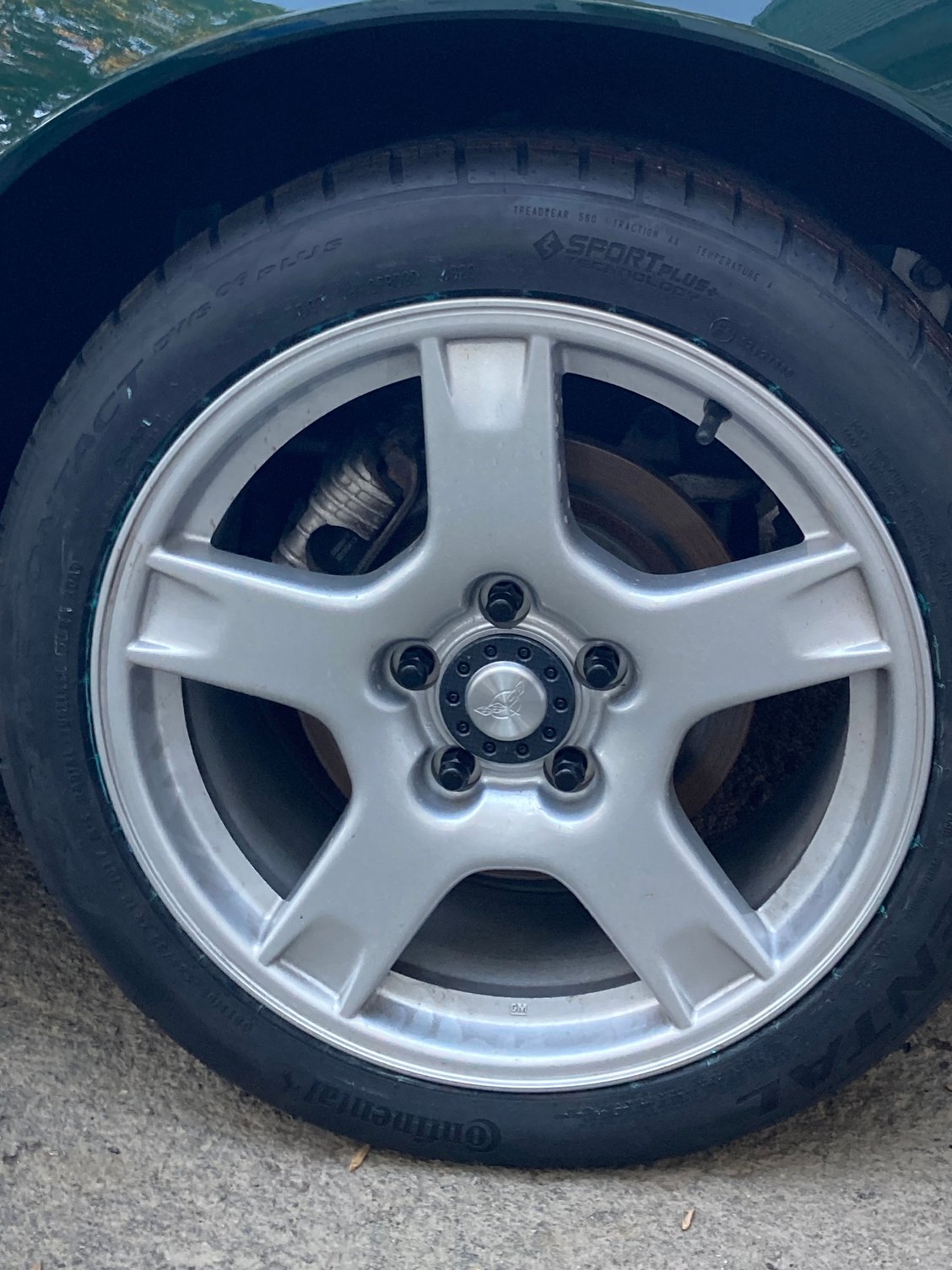

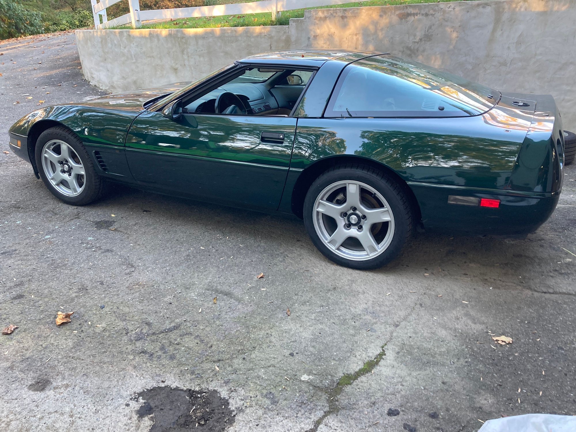

Wagon wheels on my 1995. No spacers. With 285/35-18 rear tires. Due to different offset of the C5 wheels, he rear is actually 15mm set in. I may get spacers down the road, but you dont really notice if you didnt know.
OE Center caps
Modified OE center caps with black lug nuts
