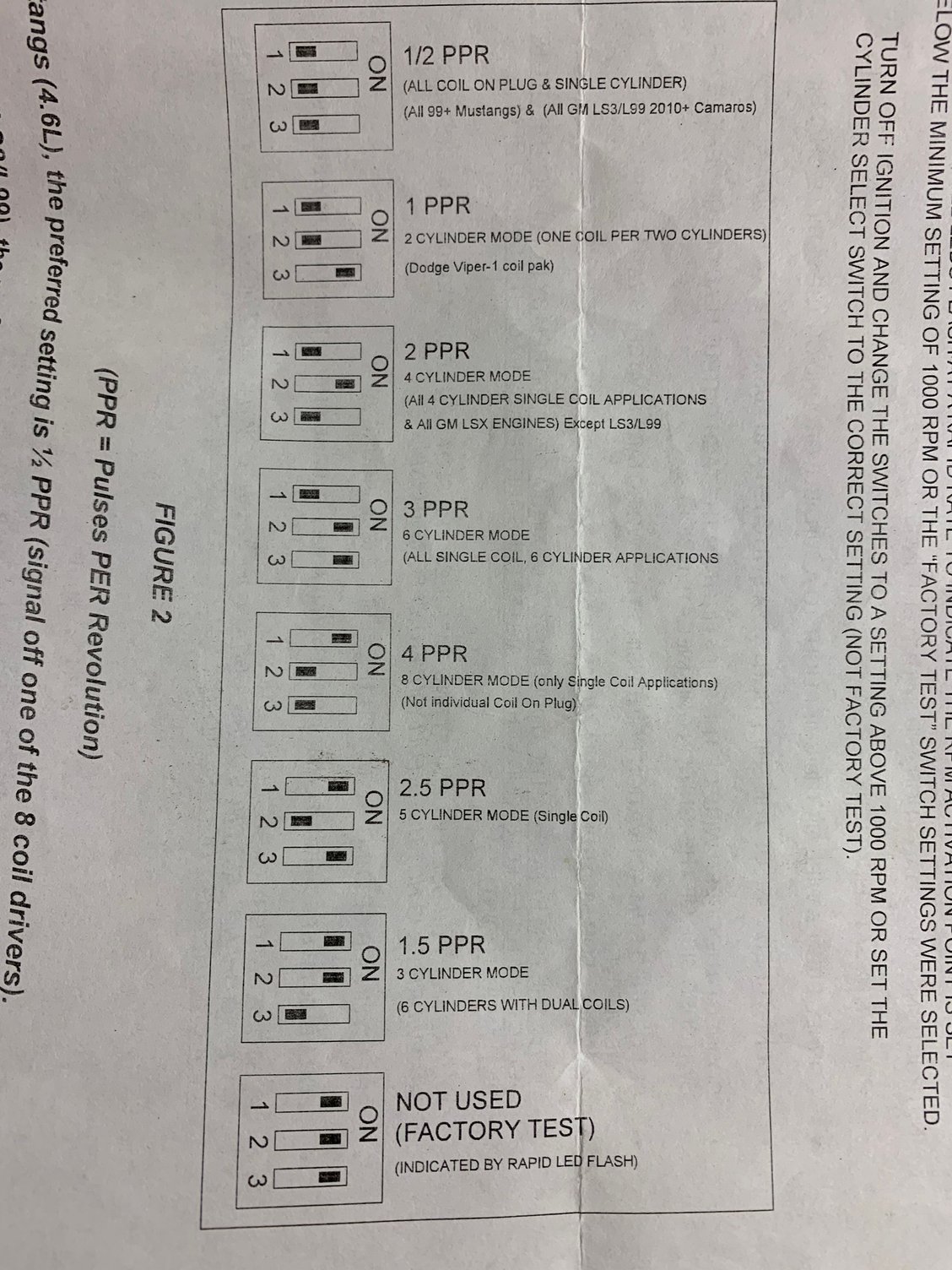

Chiming in on an old thread but hoping you guys can get me set up. Got the raptor light wired in this evening. Turned on ignition and light went thru a cycle. Two questions I have. Number one, how are the dip switches supposed to be? Ive got mine set at 1. Up, 2. Down and 3. Down(4-PPR). Is that correct? Raptors site doesnt say and the directions did not indicate on the LT cars. Now obviously, I understand the rpm settings. I have not driven the car yet but Im assuming the light will work/come on once the tach hits the shift point set on the light? Thanks.
