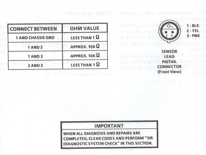

Check the resistance values of the sensor to determine if it's within range. This can be done while the sensor is still in the car. Disconnect the sensor as it enters the car behind the rug on the passenger side. As others have suggested corrosion is a common problem as well as a loose or bad connection so looking at those issues is important before replacing any parts. Be sure to disconnect the battery.
Air Bag Sensor Resistance Values
