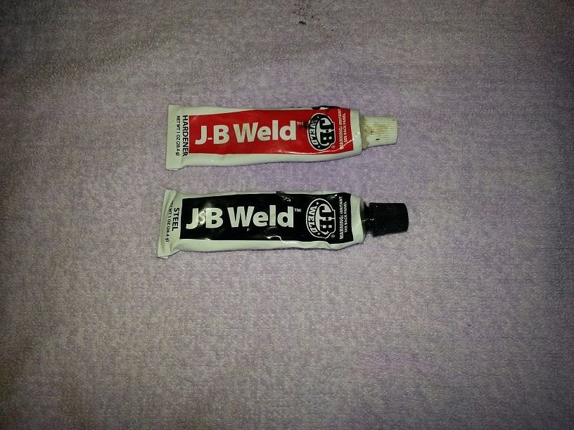

Default J-B Weld
J-B Weld...Great stuff for just about anything. Its not pretty but it works.

I've always had good luck with it as long as you rough up your fix area to give it something to get a good bite on. It's either a love it or hate it product. I'm in the 'love it' camp!
