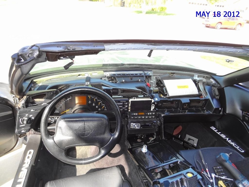

There are a few things I need to repair in the dash, and I think it would be best for me to fix them all at once. This means I need to remove the the dashboard from my 93. I was able to find information on repairing some of it without removing the dash, but so far no information on removing the dash.
Does anyone have a link or information on removing the dashboard?

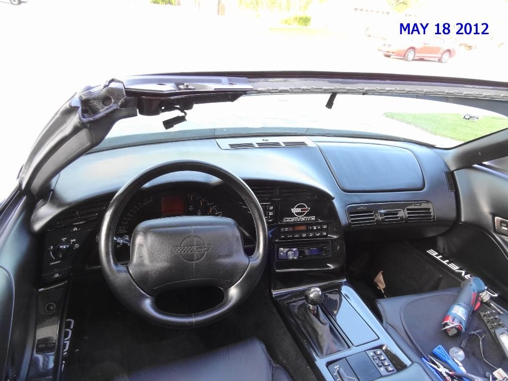

Take your time, step-by-step, and it will come off. If I remember 93 didnt have a passenger airbag. That may make it a bit easier.

I plan to get started tomorrow. Thanks for the pictures.
