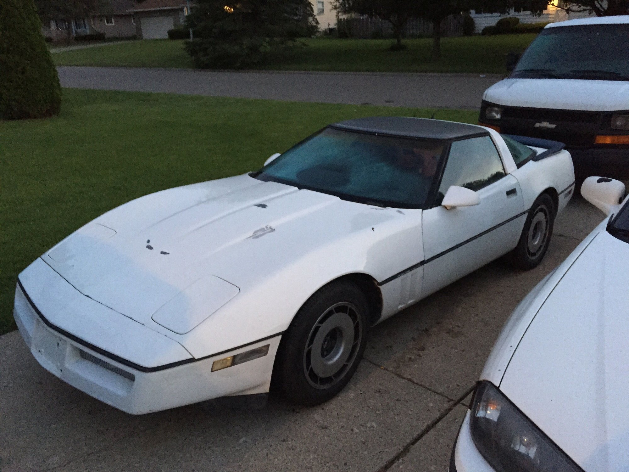

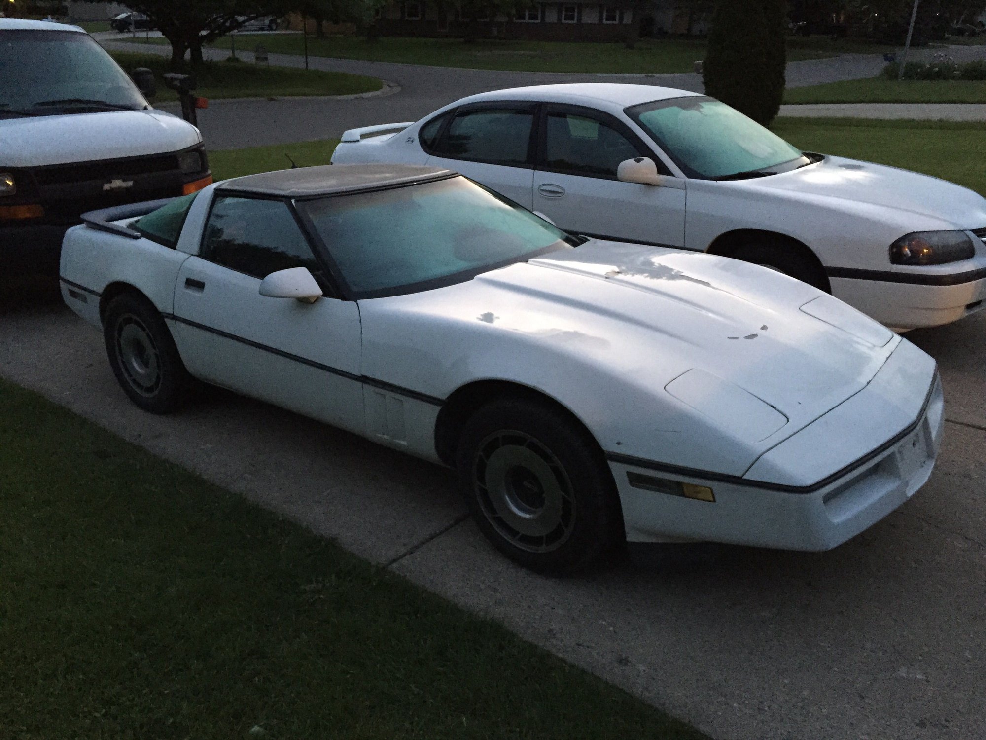

More pics!

good looking $600 vette

Looks like a great deal look at my post on cheap seats.

Your 84 looks like a lot of fun for that kind of money!
