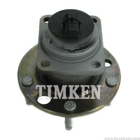

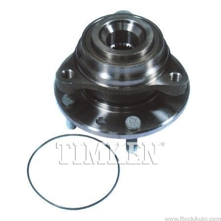

Unless EBAY has a good brand name bearing like Timken, I would go to RockAuto and go for the Timken or SKF bearings.....
$98 for rear
$191 for front
Don't get the cheaper stuff from China.....

I second Timken and Rock auto. Sometimes I go to Rock and look up part numbers, then order from Amazon prime. If it's the same price on Prime, I order from them every time. Free two day shipping is hard to beat.
