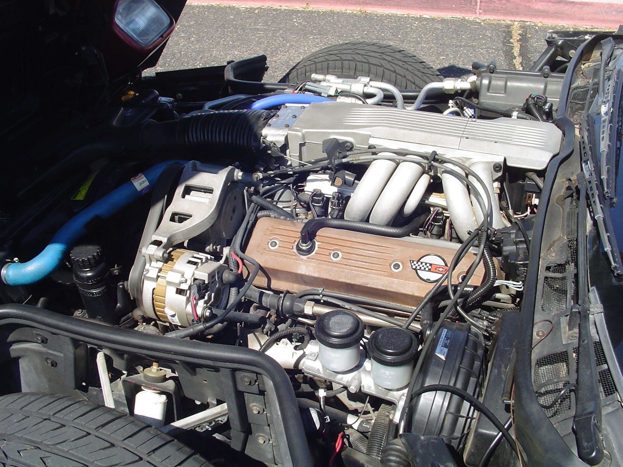

Silicone radiator and heater hoses
When my heater core started leaking I replaced radiator and heater hoses with silicone.
