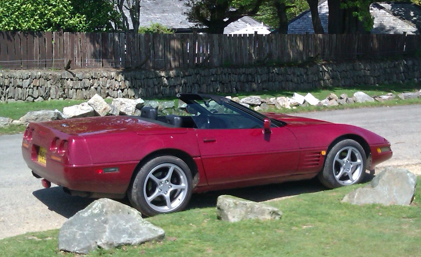

Originally Posted by Kmcoldcars
Go in the C5 parts for sale and look for a set of thinspoke wheels. They should not be too expensive and your tires will fit on them and they wheels will fit on the car with no spacers needed. Any wheels that fit on a C5 should fit on your car with no problems.
They look like this...

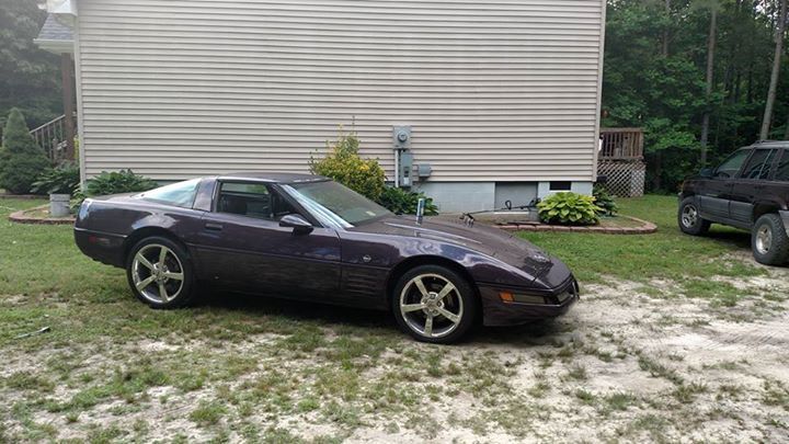

Originally Posted by spro2395
What would I need to do to make 18" thin spokes fit an 85 all the way around?
just make sure the rims you get have the proper offset or get a set of wheel spacers. Here is my '92 with c6 18" front rims and c6 19" rear rims (rear rims required a 1" spacer). First two pics are just after putting the rims on the car before moving it. They sit higher in the wheel wells, like seen in the close up pic.
On my '93 they bolted straight on with no clearance issues. I'm probably going to fit 1.5inch spacers to the rears to fill out the arches better though.
