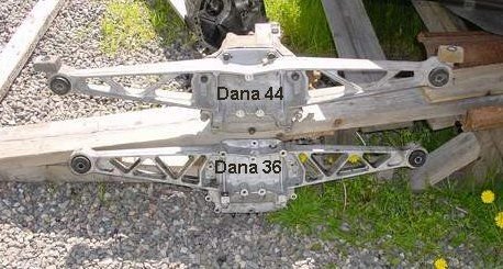

Is there a way to determine whether a C4 has a Dana44 or 36 from its VIN #?
If Not, was there a certain engine size or tranny combo that would tell you?
Thanks for any help

1984 = All were D36
1985 - 1996: Automatic = D36, Manual = D44

You can't tell from the vin really but there should be a tag on the rear end, plus if the PO swapped one in like I did you won't know. You can google images to see the differences.

As mentioned a manual trans car would have the D44 unless already removed and sold! Happens. Through '88 the rear gear would be a 3.07, an '89 early car a 3.54, later '89 3.33, '90 a 3.33 unless a ZR-1 then 3.45, '91+ are 3.45 but there's reported 3.54's.
