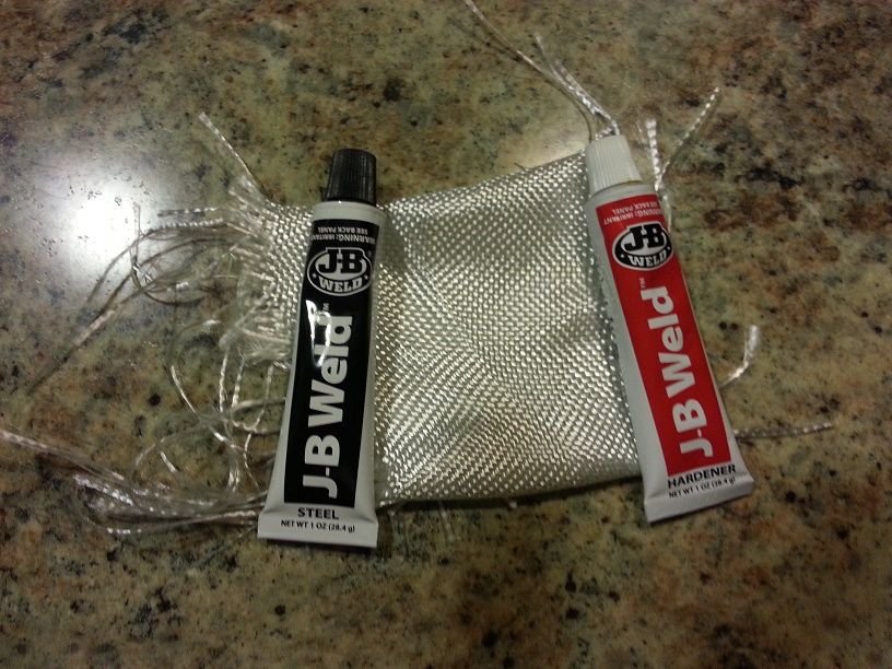

J-B Weld

Also fiber glass matting works great with J-B Weld for added strength.
