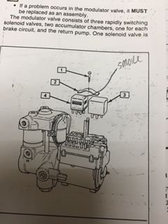

This all started with a caliper slow to release (right front). I'm resigned to replacing the modulator valve (pump) if I can find one, but was just curious when pulling the solenoid relay off the pump, why I got vapor and hissing. Weird (to me)....Are the relay's pressurized with a gas to protect them? I'm going to try to upload a couple of pictures; one from the actual unit, the other from the fsm.
#4 is the one that started hissing/smoking when attempting to remove
actual abs pump in car; silver colored relay is the one I'm questioning
They are not pressurized. There is a lot of exposed connectors under the pad the relays are connected to. I suspect you had some arcing when you pulled on it.
