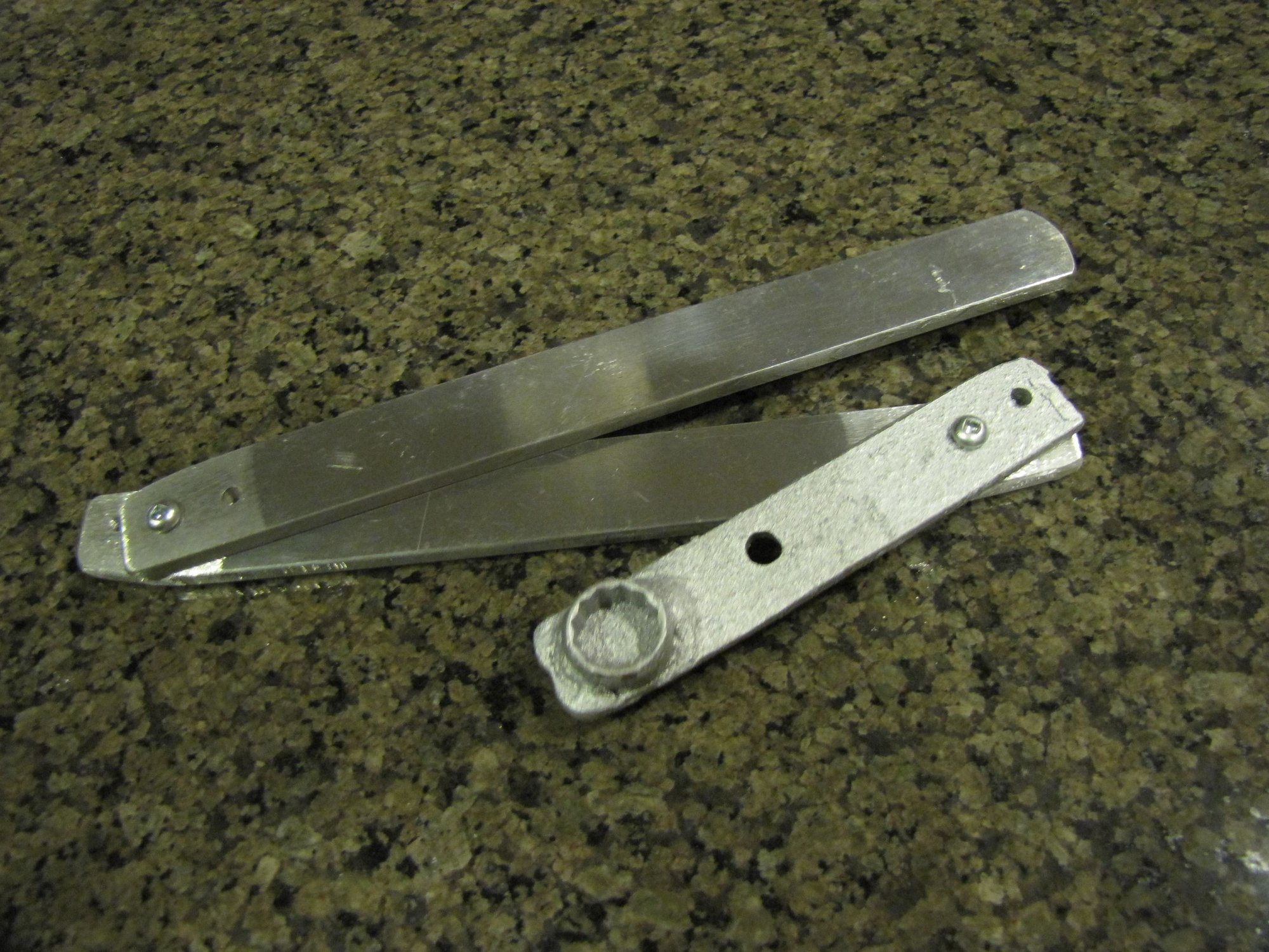

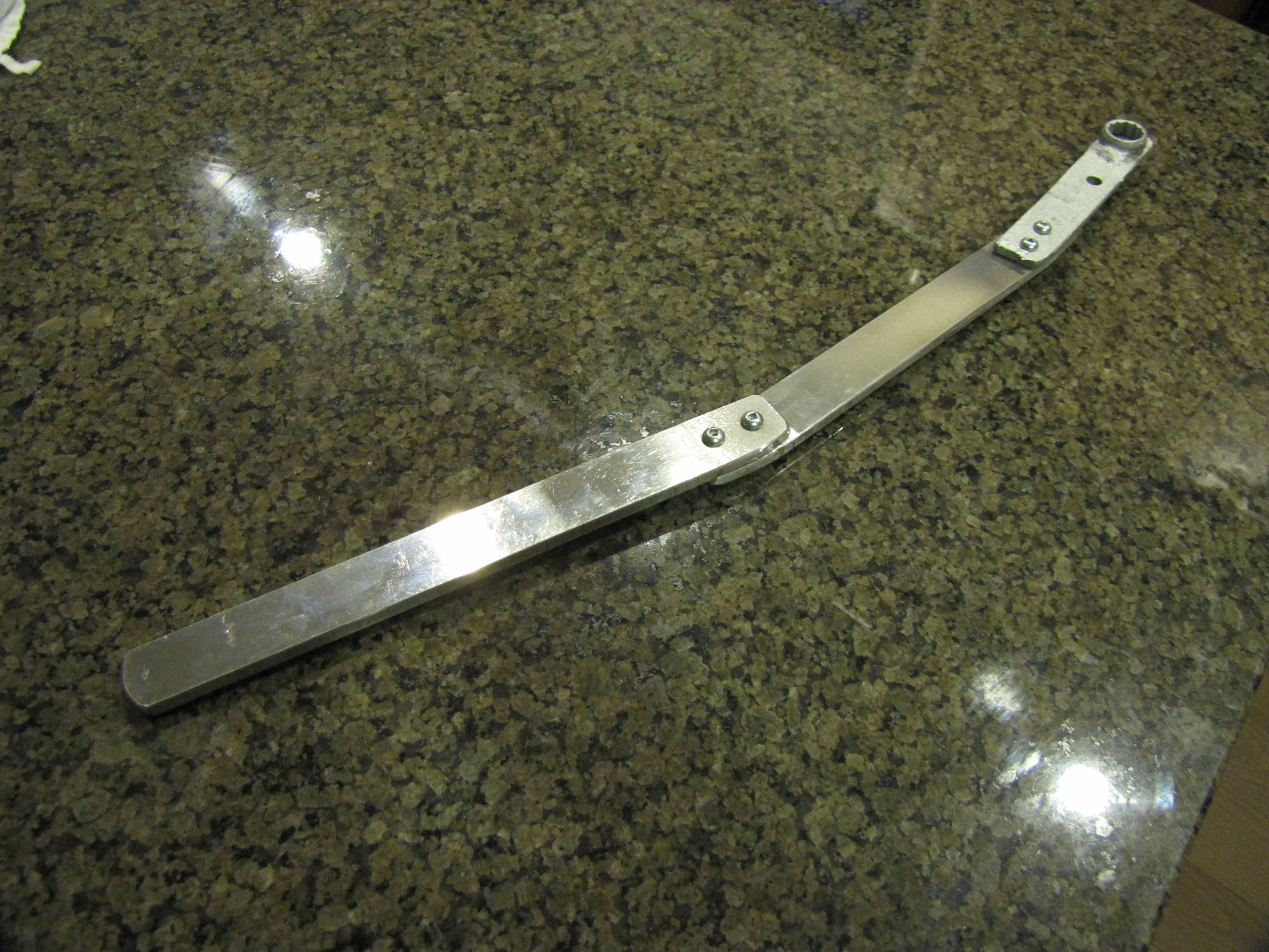

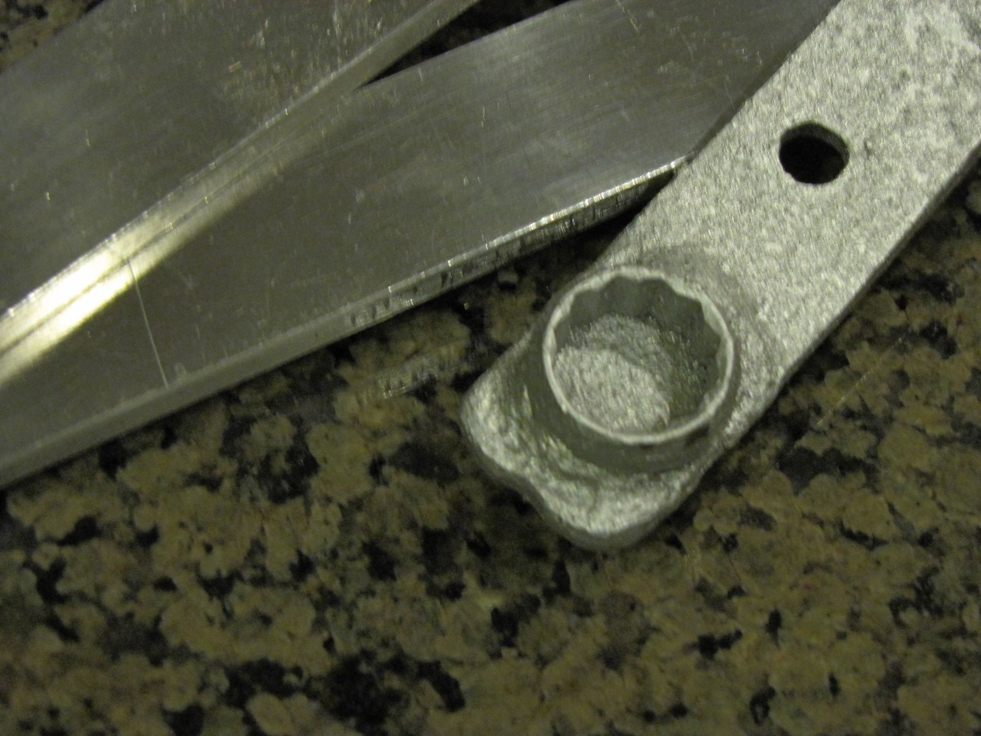

For that exact reason, I made a folding tool that I keep under the seat:

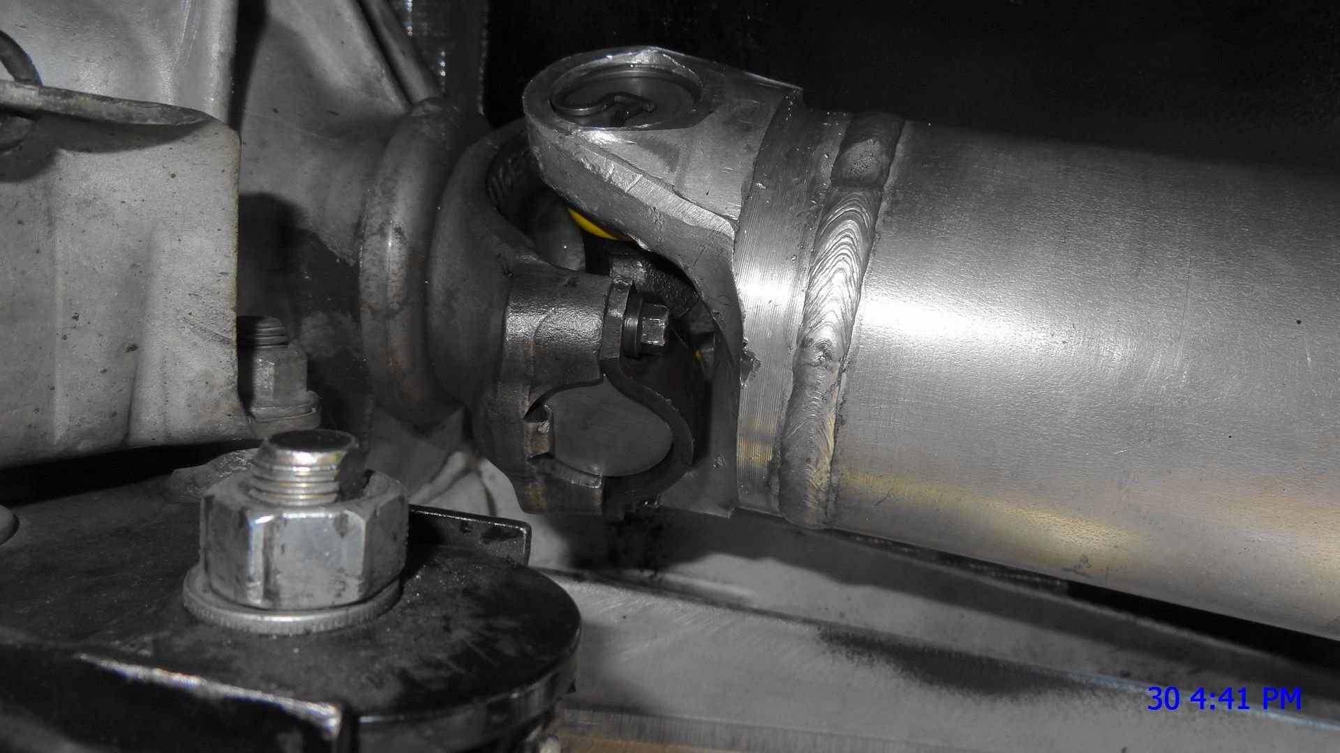

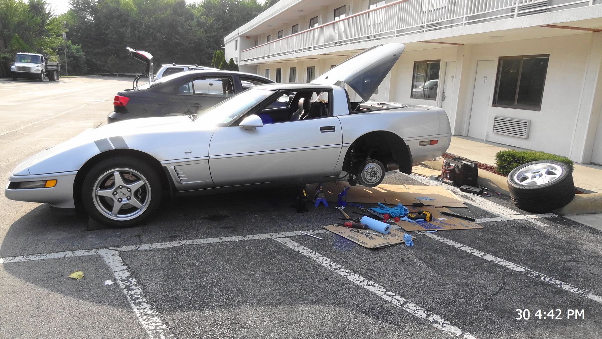

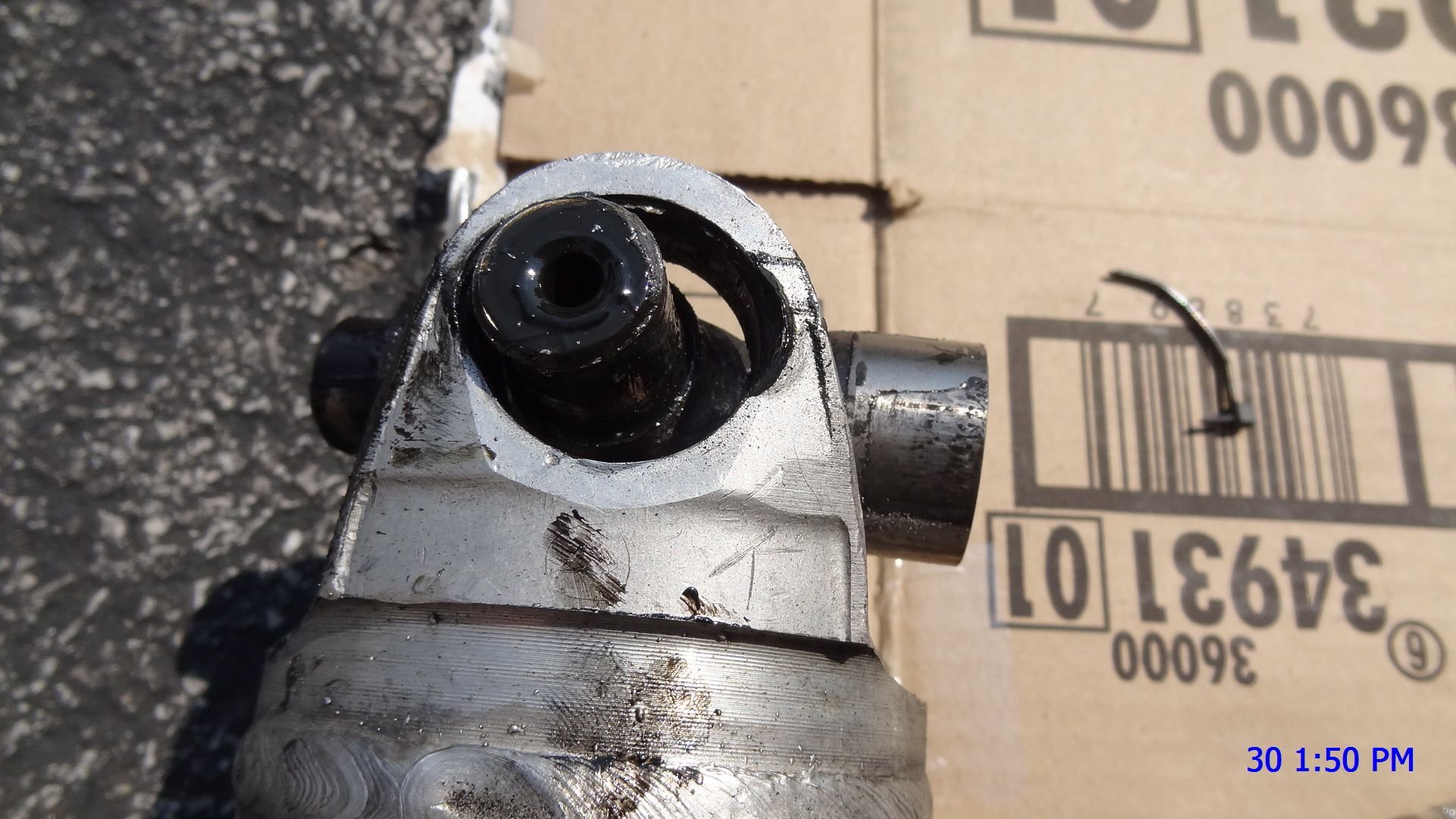

Originally Posted by 73n95
I'm not interested in something that will let me change a U joint
You would never know whan having those tools on hand may become handy.
I broke down on Elyria, OH

Wow! In a motel parking lot. That's impressive. I'm sure you got a few "So watcha doin?".
