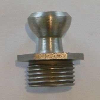

I think there is a lot of confusion on the stud threads.
To make is simple, use a 12 mm allen socket and turn clockwise to loosen it.
The definition of standard or reverse threads comes about because you are turning the allen head from the opposite side that the stud was installed from.
If you look at the picture below you can see the stud has a standard thread. Not a reverse thread. But from the opposite side, you turn it the opposite way to loosen it
This is correct. Just removed mind. You turn it into the bell housing to remove. Must remove retainer first. In my case it fell out......!!!!! when I removed the transmission.
