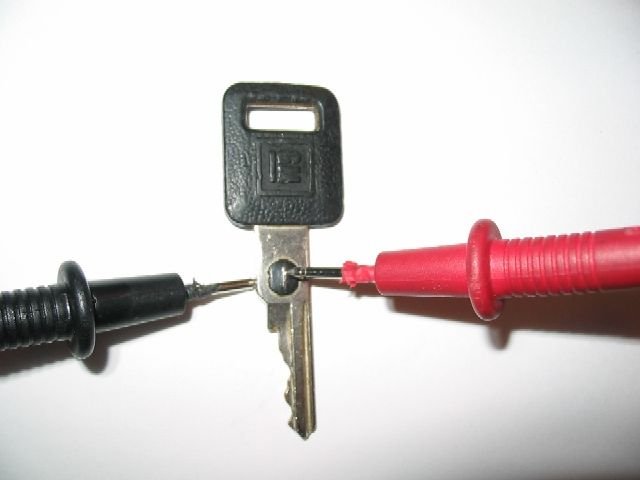

Check out "vatkey.com". They explain how you can retrieve the code using a simple ohm meter. The actual cutting of the key will probably have to be done by a locksmith. You'll probably have to have the locksmith come to your place and get the key pattern. Not a big deal but sure to cost more than the duplicate key you wish you had made. File it under "lessons learned". Good luck.

Here's a chart for future reference. It's a good idea to take a reading and tuck it in you wallet or the like, just in case you want a duplicate made someday...
