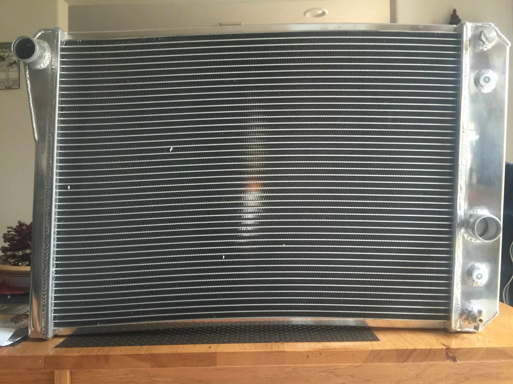

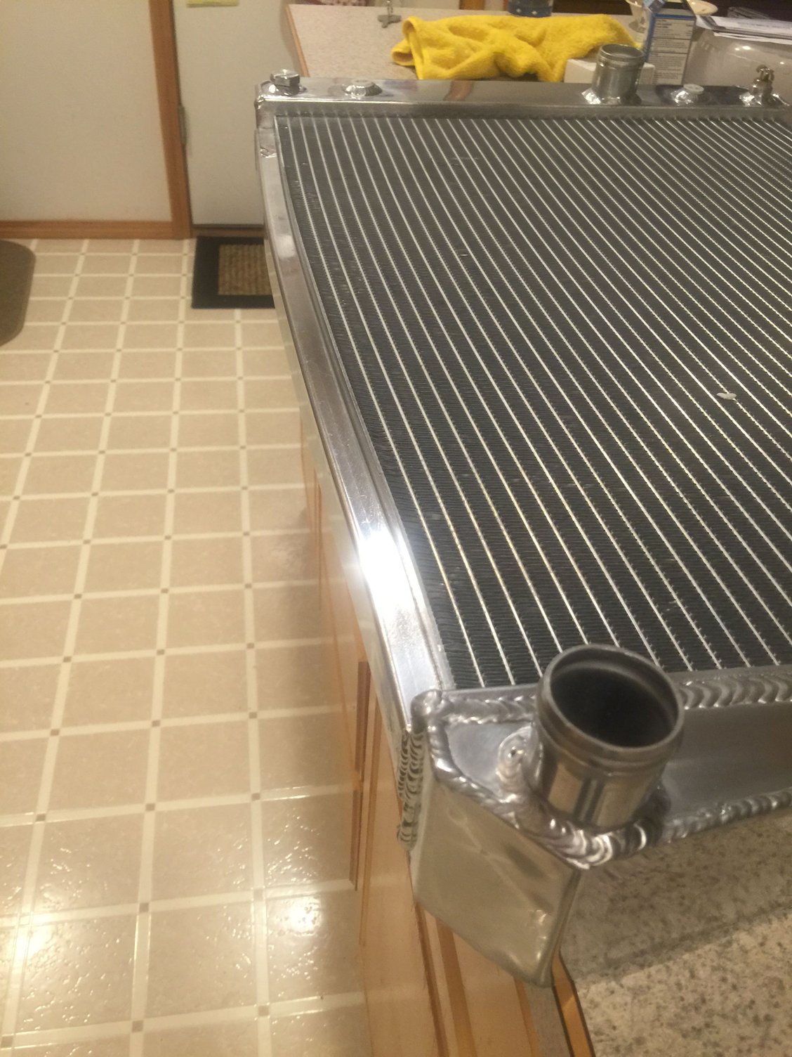

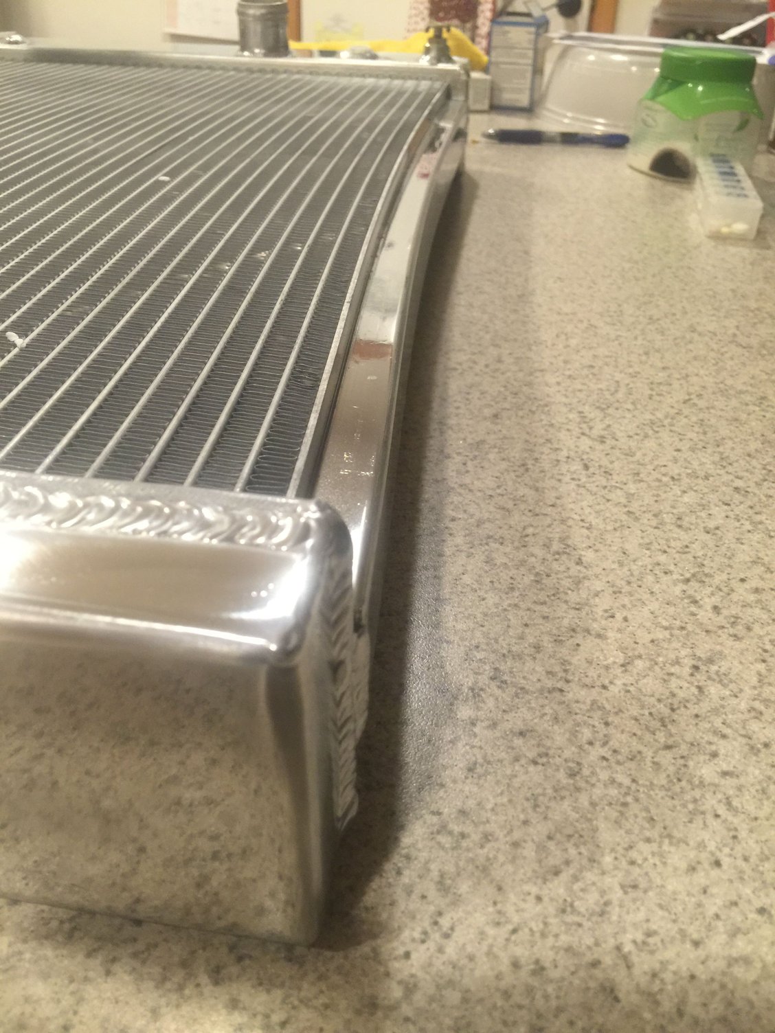

Update on the Engineered Cooling Products radiator I bought. Unfortunately, it is warped and distorted enough to have to return it. Also, it does not have the tube for the reserve tank overflow hose, only a threaded plug that I would have to go find an adapter to fit it. The threaded hole is not a pipe thread so I would have to use some kind of thread sealer, a possible leak point in the future. Communication with the company has been good and I am awaiting an RMA. I had high hopes for this product and I would've probably used it if it wasn't so warped and it had the right fittings. The welding looks good and overall seems to be a decent radiator. I just don't want to risk fitment issues and possible leakage considering the labor involved in replacing a C4 radiator. I suppose I'll bite the bullet and go with Dewitts.

I certainty hope the shipping box was damaged, otherwise; that's how it left Quality Control!

The box showed no impact damage, nor did the radiator itself. I was told by the seller that it can happen due to the heat process, but you're right. It should have been melted down and remade. I would have accepted a replacement but they said they do not open the boxes to check for defects (designed in US, made in China), nor could they weld on the missing nipple for the overflow tube. So back it went. On the bright side, they paid return shipping and waived the 20% restocking fee
