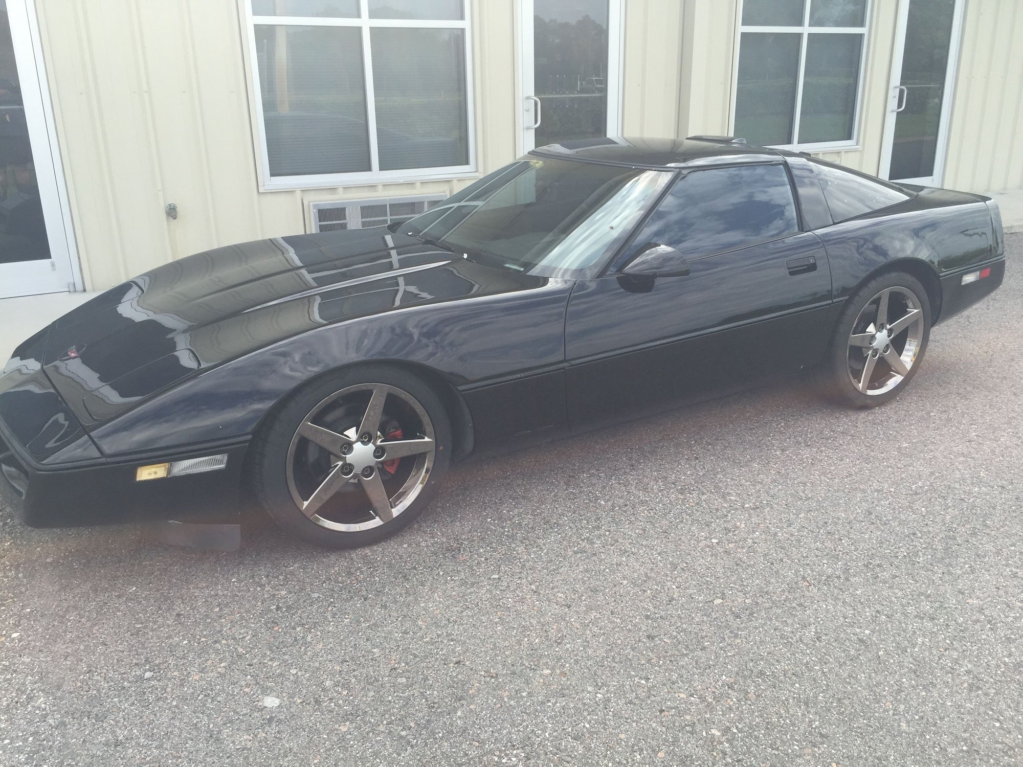

I'm running these rims on my 1990 with
These tires it has also been lowered 2 inches
