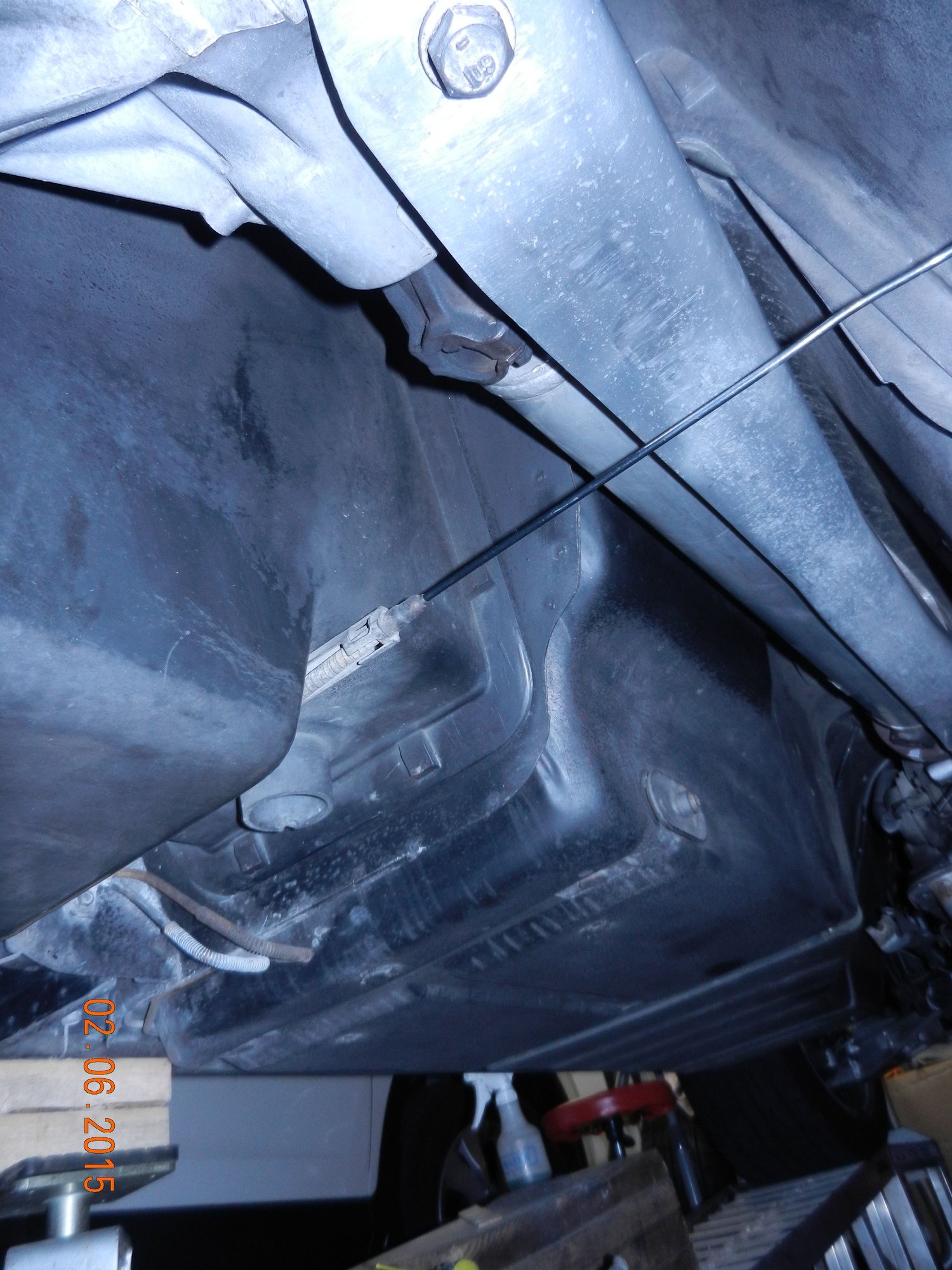

NO NEED TO REMOVE THE "C" SUPPORT BEAM! first thing is to mark the orientation of the drive shaft in relationship to the differential yoke. unbolt the u-joint straps at the rear end, slide it forward slightly and drop it down until you have interference. you will note this interference is with a sheet metal flange near the rear end of the driveshaft. take a small grinder, and remove about 1/8 X 1.5 inches from the flange. the grinding area is very small, and outside the spot welds. it will have no impact on the cars structural integrity. the drive shaft should drop out without issues.
here's a old post on the subject -
https://www.corvetteforum.com/forums...to-pinion.html
here's a couple shots of the area I'm talking about -
hope this helps....
