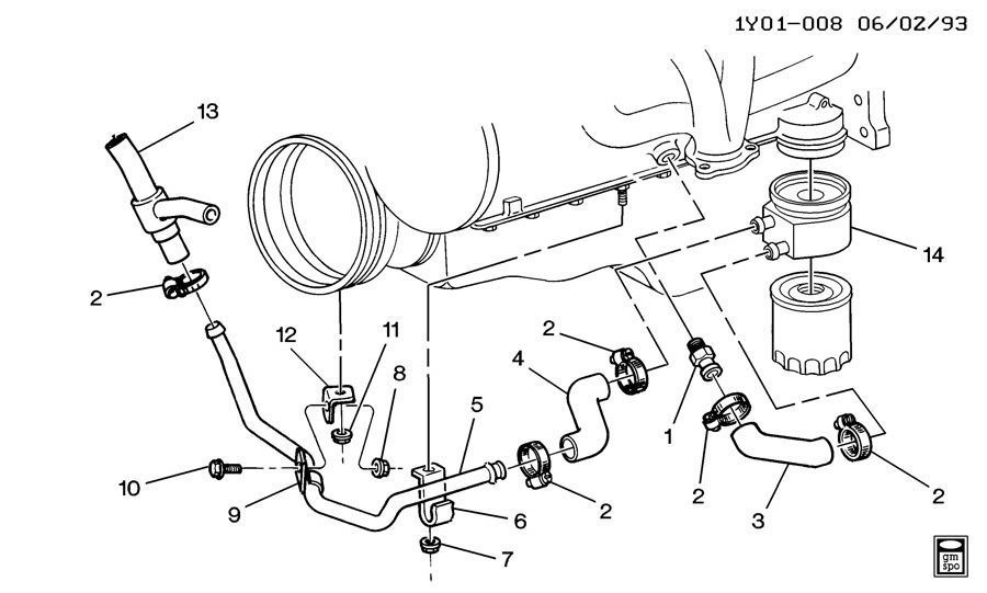

Is your car equipped with the optional oil cooler? If it is then coolant is routed by pipes and rubber lines to the oil filter housing. My 91 leaked there and the fix was to replace both the rubber hoses. Cheap repair.

Thank you guys for the responses. Looks like I know what I'll be checking out this weekend. One last thing regarding that leak...if it is what you guys mentioned why wouldn't it drain the reservoir ?
