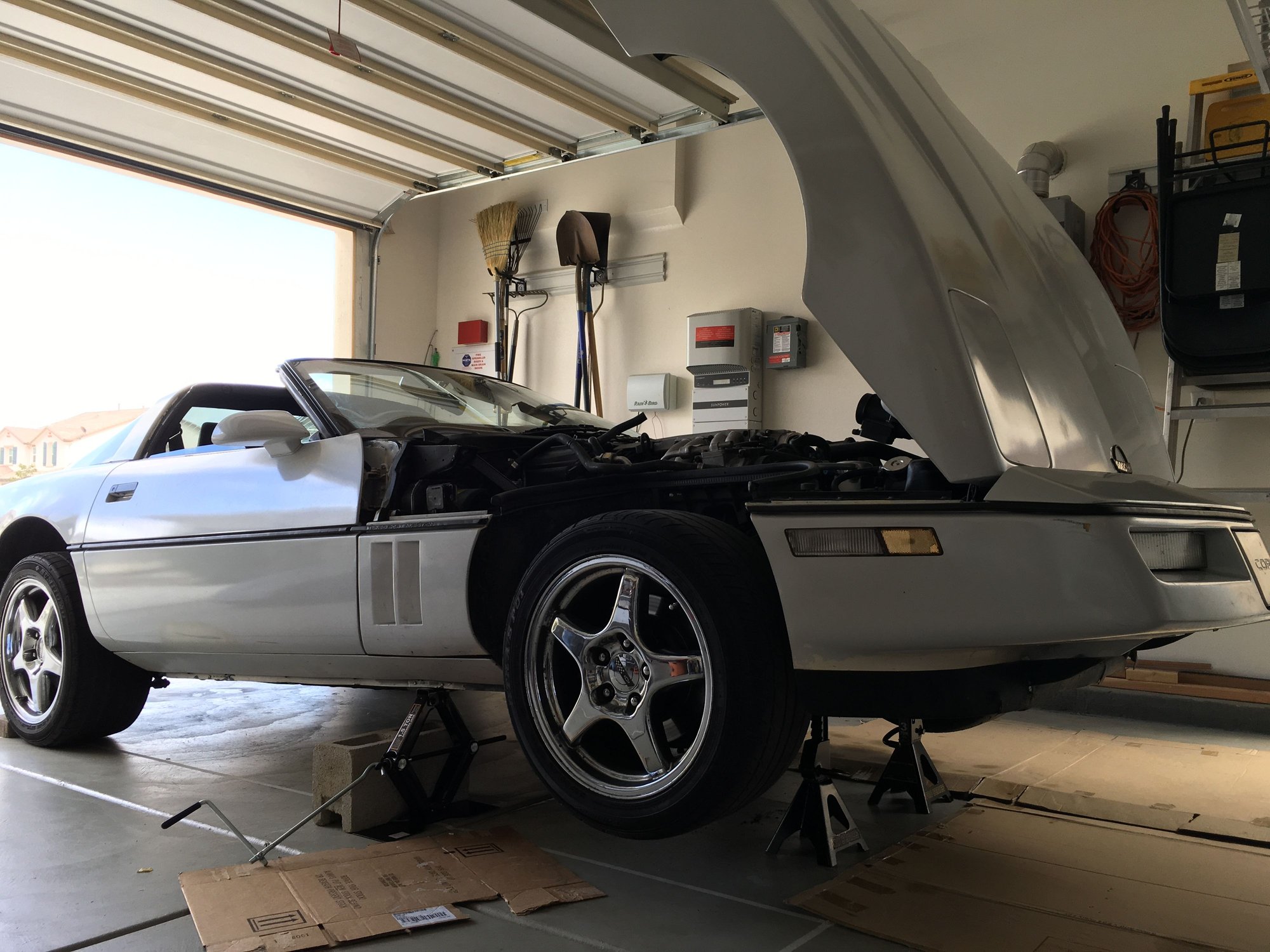

Old May 5, 2016 | 04:57 PM
DGXR's Avatar
DGXR
Joined: May 2013
Posts: 2,692
Likes: 349
From: Sacramento California
The side rails (pinch rails) behind the front wheels have an arrow \/ showing the jack points, those are intended for the emergency jack in the car but give a good idea where you are supposed to support the vehicle weight. Most people say put the jack under the side mirror to lift that side of the car, and I have been doing this for years with no issues. I put a wood block between the jack pad and the rails. Be careful of steel lines running along the rails, don't damage them.
Jack up one side, support that side on stands. Then do the same to the other side. Before getting under, give each corner of the car a few solid bumps with your hip to be sure it's secure. Also a good idea to put a wheel underneath with you, if you have them removed... or anything else that's solid and 1' tall. Be safe.

I used 2 scissor jacks on each side going a little at a time on each side. The scissor jacks were $25 each at walmart then used 3T jack stands 2 for $25 at walmart too. for the back just move the scissor jacks to the back jack point and use block, or other jack stands too where they'll be safe and out of the way.

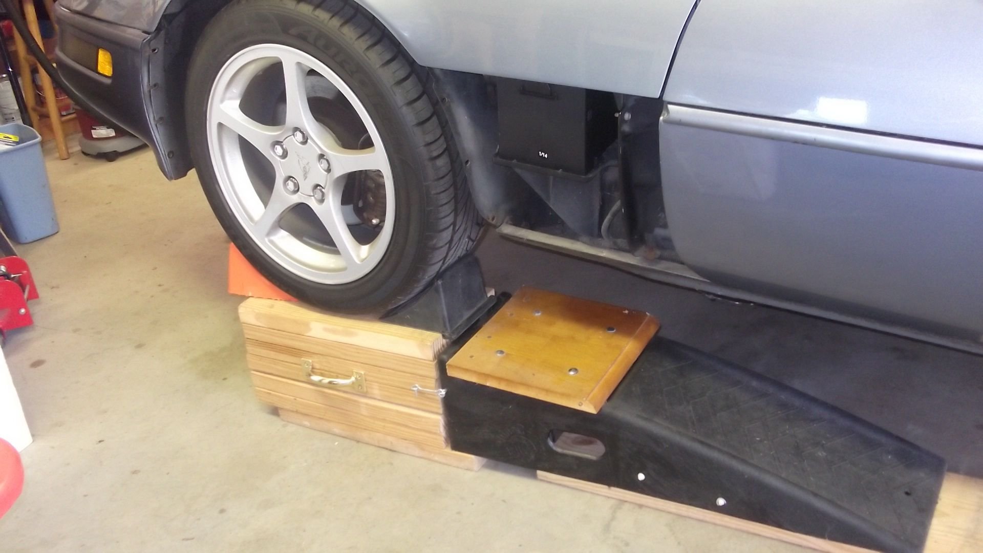

corvetteronw's Avatar
corvetteronw
Joined: Feb 2003
Posts: 16,475
Likes: 270
From: Kingman AZ
Cruise-In VII Veteran
Cruise-In VIII
St. Jude Donor '06-'07-'08-'09-'10-'11-'12-'13-'14-'15-'16
www,corvettegadgetman.com
Old May 5, 2016 | 08:20 PM
corvetteronw
Joined: Feb 2003
Posts: 16,475
Likes: 270
From: Kingman AZ
Cruise-In VIII
Front raised by using home made ramp and rear raised by using the JackAVette from the Corvette Gadgetman.

csthews's Avatar
csthews
Joined: Apr 2011
Posts: 917
Likes: 25
From: College Station Tx
I drive the front wheels up on race ramps. I then Jack up the rear and slide in rhino ramps. This gave me plenty of room to install a magnaflow cat back exhaust and driver's side cat.

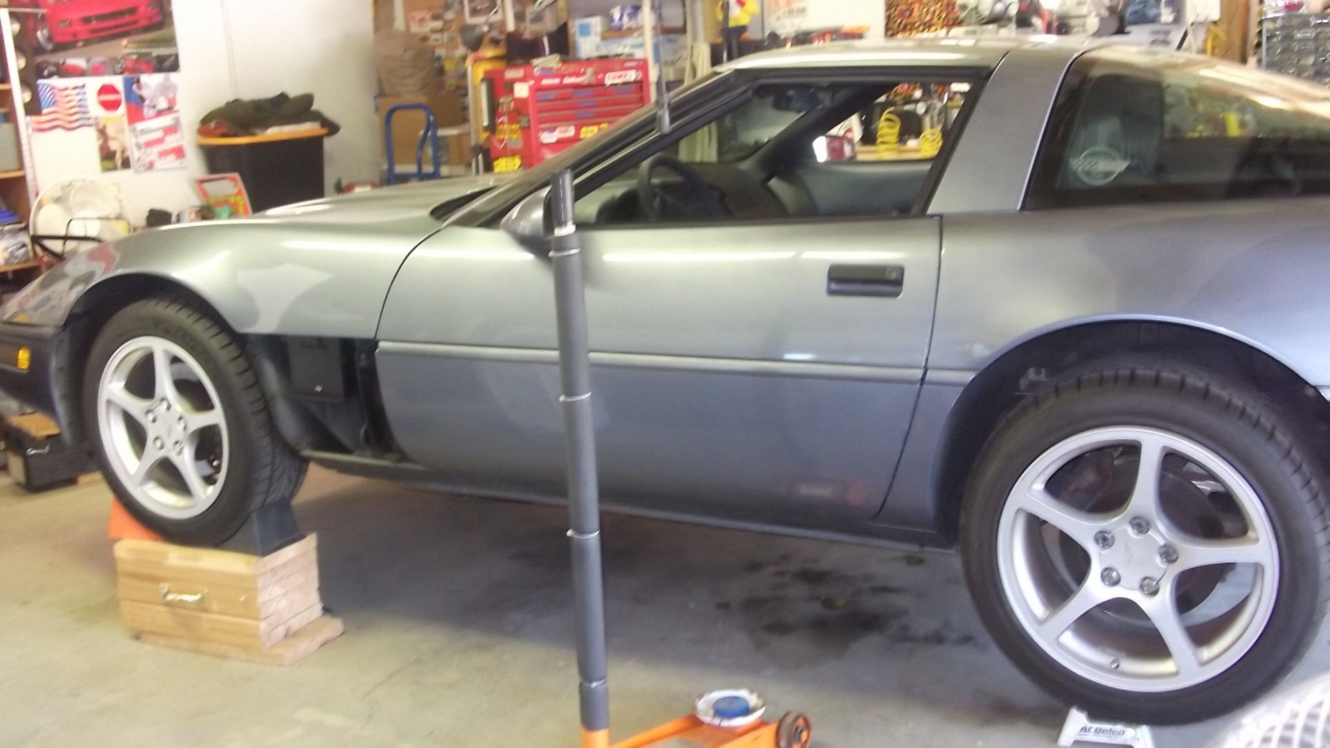

Joined: Aug 2004
Posts: 21,543
Likes: 3,216
From: Park City Utah
Originally Posted by trilkb
without the feeling of tweaking it .
Are you against driving through a gutter at an angle? Because that will "tweak" your car more than jacking it will.
If you jack form the front point that this gentleman shows in the vid, the whole side of the car will raise. Install your stands for that side...jack and support the same on the other. Have the car up in the air w/one jack, 4 stands, in less than 5 minutes.
Ah, no. That's the front jack point, jacking there will raise the front corner.
Whole side jack point is straight down from a side mirror.
