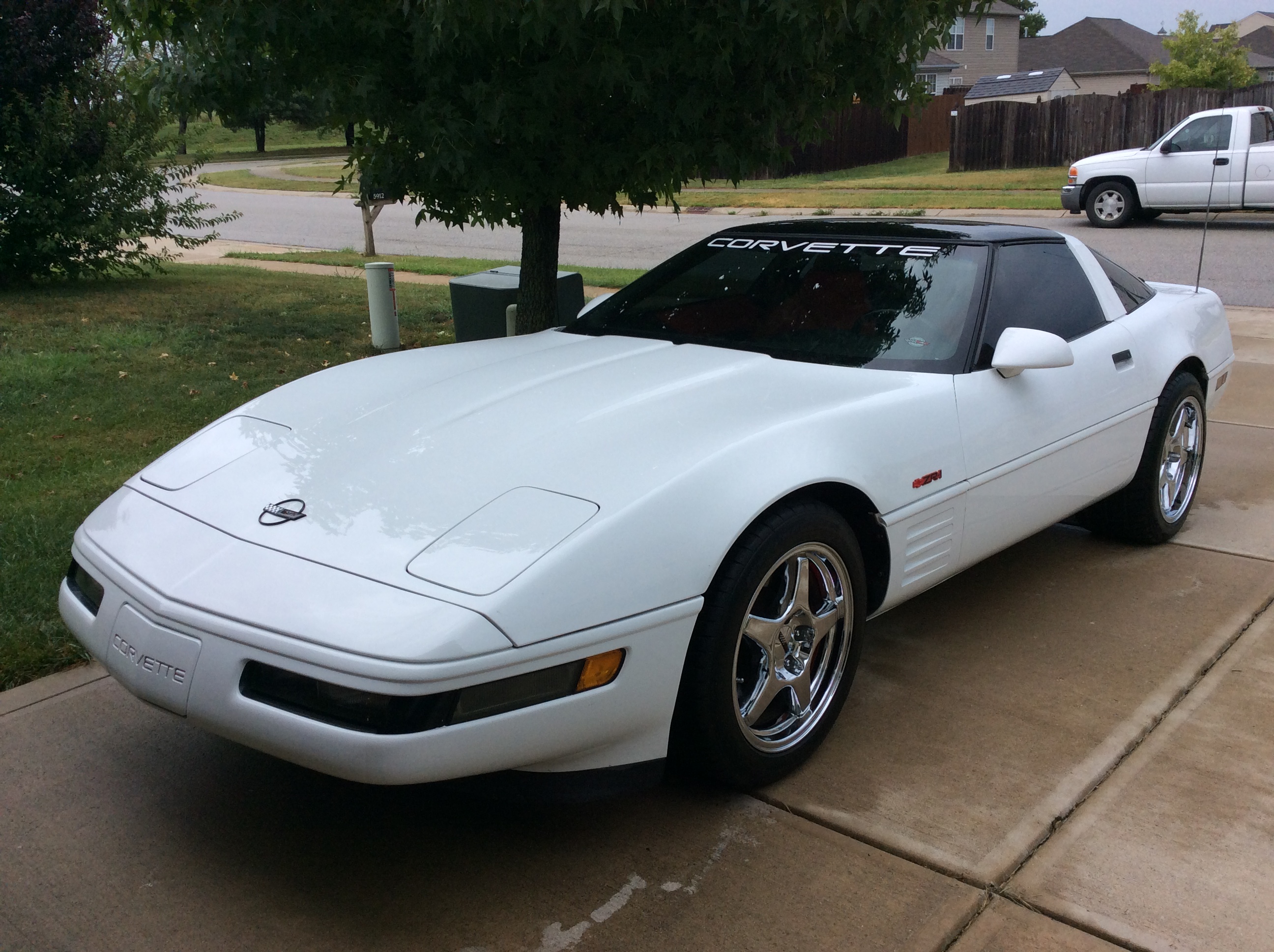

You don't need the VIN for the FOBs BUT it always helps when visiting a dealer you carry the VIN with you. The C4 didn't use the basic "clicker"(your terminology) as a key-less entry. The remote is a "PROXIMITY" device and requires programming. Did you get an owners manual for the car? If yes check it. If NOT get it here and you don't need to establish an account or login to get the owners manual.
https://my.chevrolet.com/home?evar18...nce_chevy_logo
The hood emblem on your car is LT-1 OR maybe LT-5? I don't see the CHMSL on the rear backlite so I hope you didn't pay a "premium" assuming you bought a ZR-1. If it was sold to you as a ZR-1 - hurry back and get your money back or maybe a partial refund.
Post either the last 8 of the VIN or maybe the first 8 of the VIN to validate the buy. The ZR-? emblems are incorrectly colored for a WHITE car also.
I'm not concerned but maybe just looking out for your "wallet"!!

It's not a ZR1 - PO put those on. It's a LT1 and I do have the owners manual. Please I'm a rookie on some of the terms - FOBs, PKE, CHMSL - ??? Thx
So long as you're aware of what you bought "all is well"
PKE - Proximity Keyless Entry
CHMSL - Center High Mounted Stop Light (yours is in the center of the rear bumper fascia) the ZR-1 was still "HIGH MOUNTED" on the rear glass through the end of production. It would have been seen in the snapshot as it's car color and can be seen easily in profile snapshots of the car.
