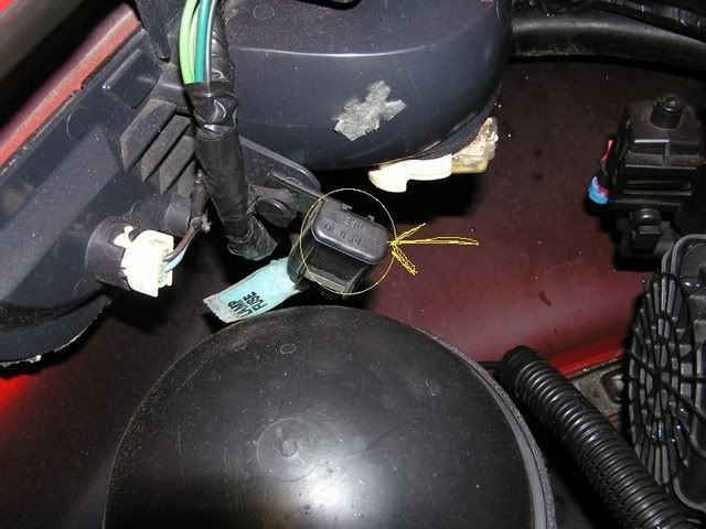

pulling the fuse takes seconds compared to unplugging them. seems too much work to put in a switch
Left front wheel well. You can see the fuse holder next to the left front side marker harness.
