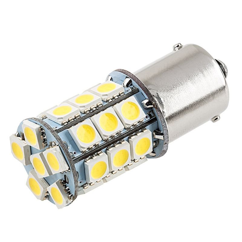

Likes: 31
https://www.superbrightleds.com/more...ofit-car/1643/
https://www.superbrightleds.com/more...ofit-car/1326/
I found these bulbs today. I am curious if they would be noticeably brighter or not.
I will say.. no they will not. they don't utilize the reflector

Likes: 31
https://www.amazon.com/gp/product/B0...?ie=UTF8&psc=1
I found these on amazon, and appear to be the same.
