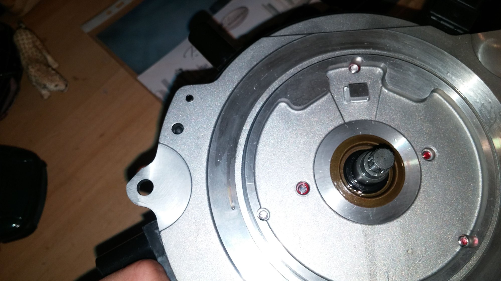

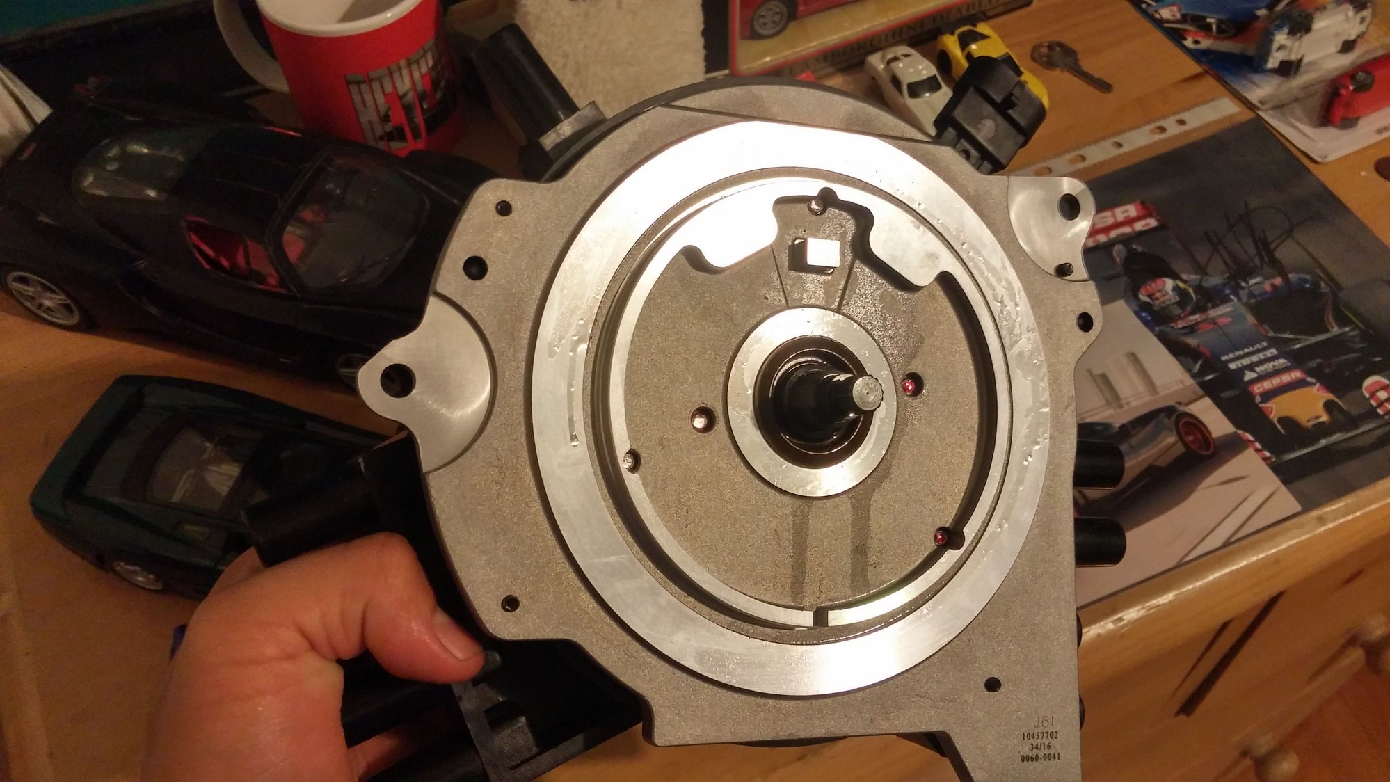

Got my LTCC yesterday. And got the LS1 coil packs a few days ago. I ordered the same(as TorchTarga94) brackets, and LS1 coil pack relocation harness off CBM. I received my new opti today, but I might return it, see pic below. This is an Opti from saccitycorvette, they sell them from AIP Electronics. It came out of the box wet. It's actually some kind of grease. It smells like grease/oil and feels like it to.
PLRX, did you remove the rotor from the opti?

No, I let the opti in place.
Many told you to buy the Petris, AC, or Delphi. It is good to listen to 30 year old advise. Other optis have a great fail history in the forum. I bought the MSD optis in 2008, and I'm one of the few with no issues.

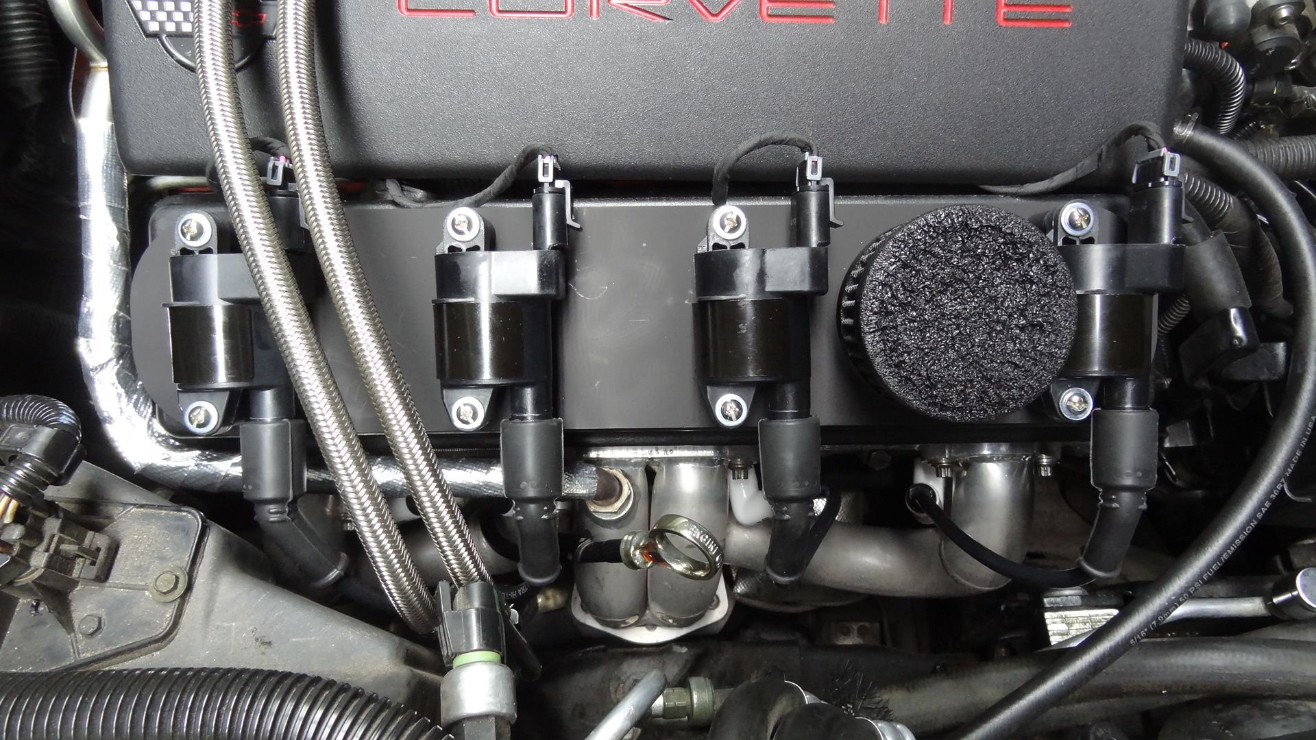

I finished my LTCC conversion about a week ago and the install wasn't that bad. The one thing that wasn't clear was how to hook up the tach feed if you have a tach filter.
https://www.corvetteforum.com/forums...post1593774555
here is my install. I'm currently using the same wires I used when I used the optispark as a distributor. ran out of time to order some cut your own wires.
