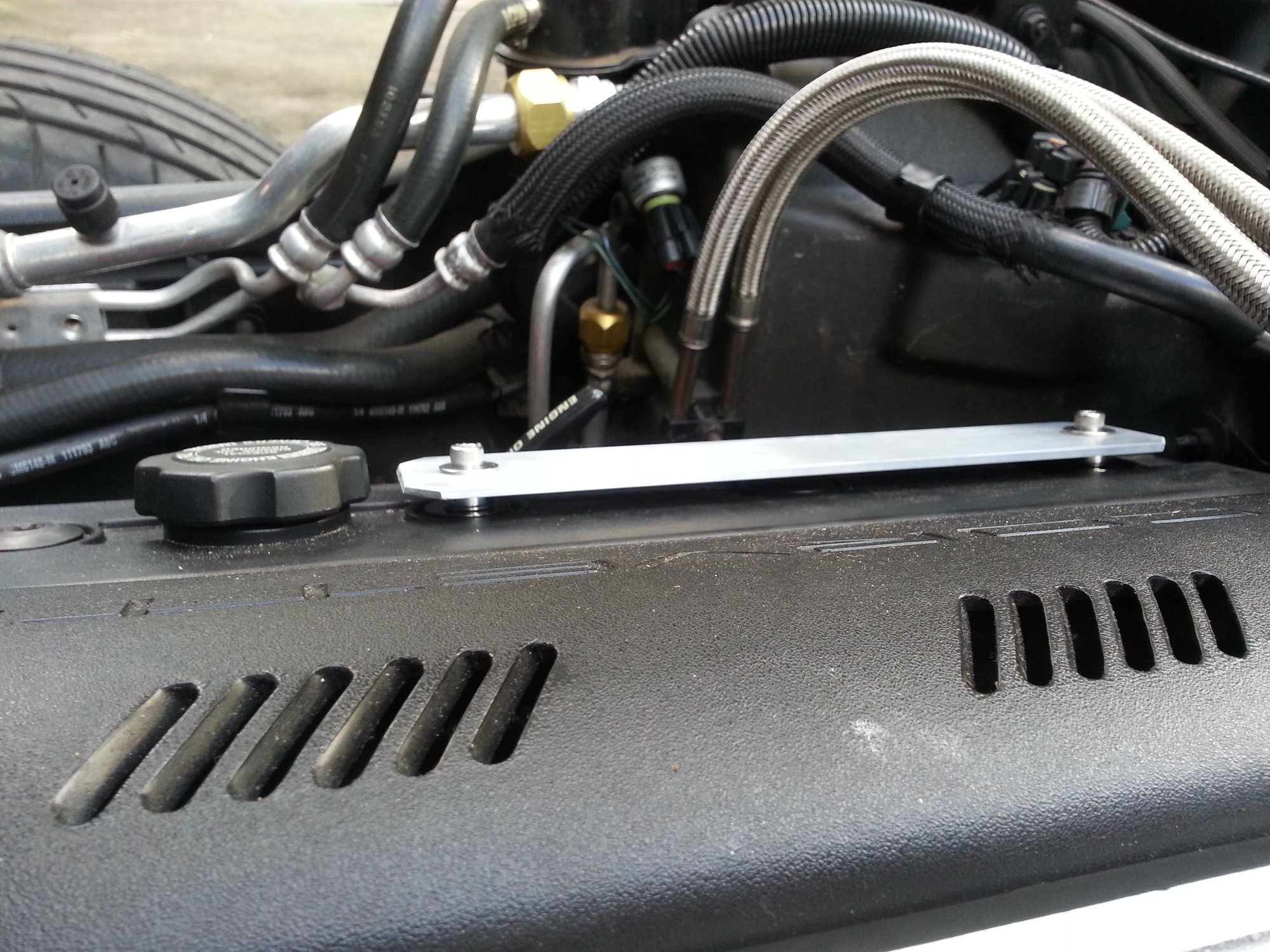

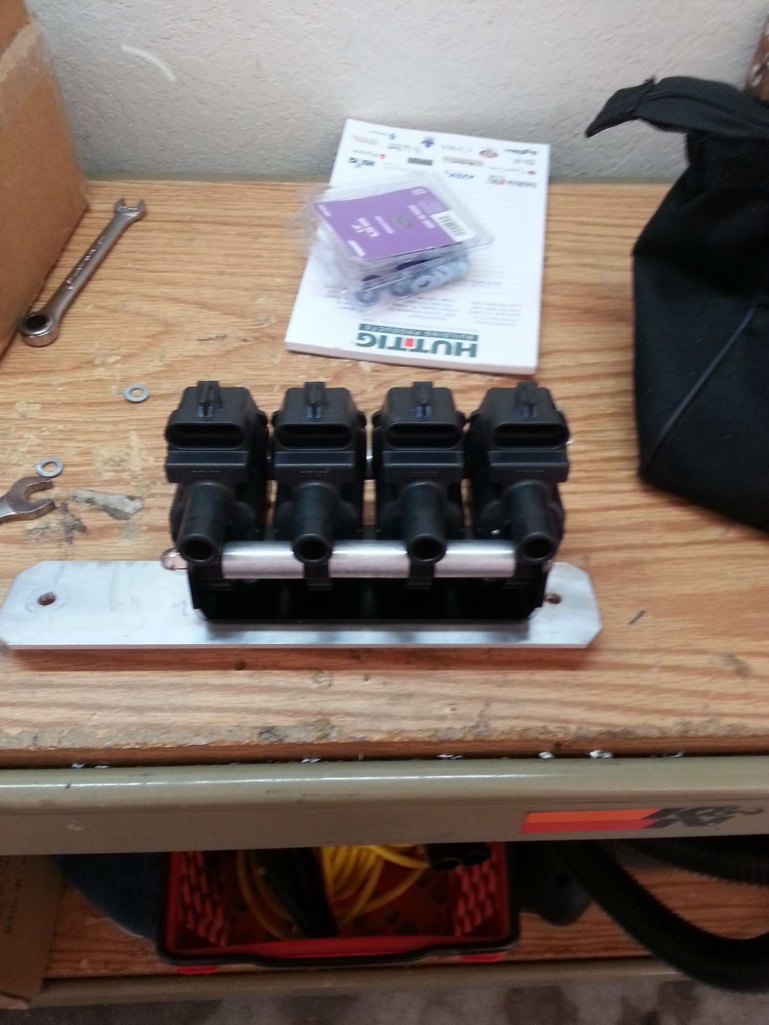

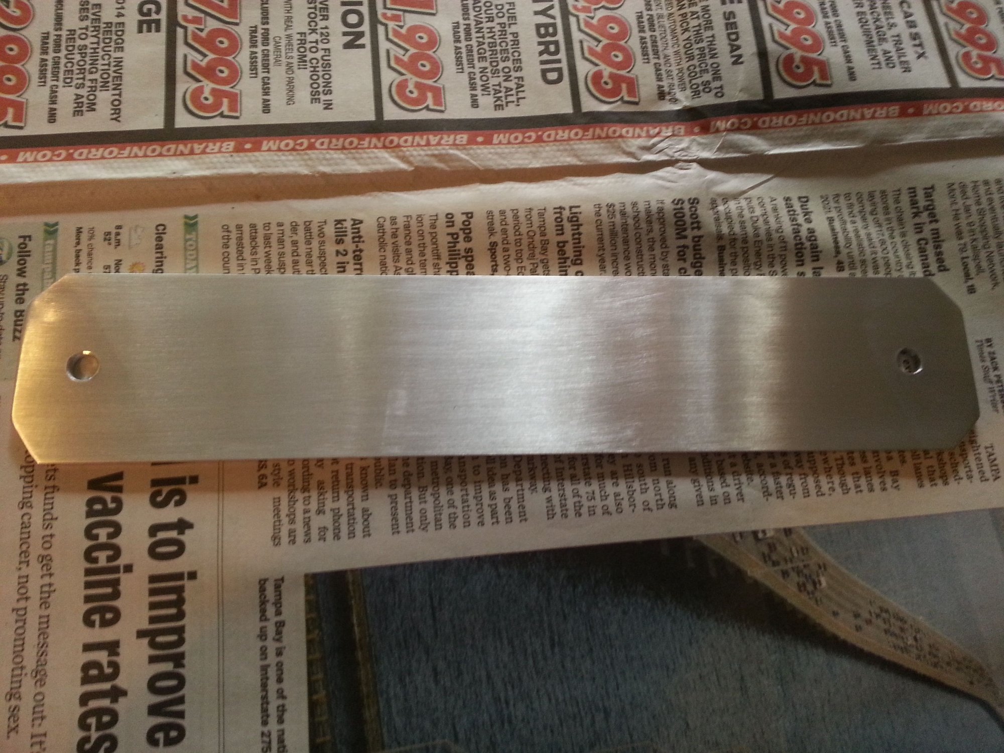

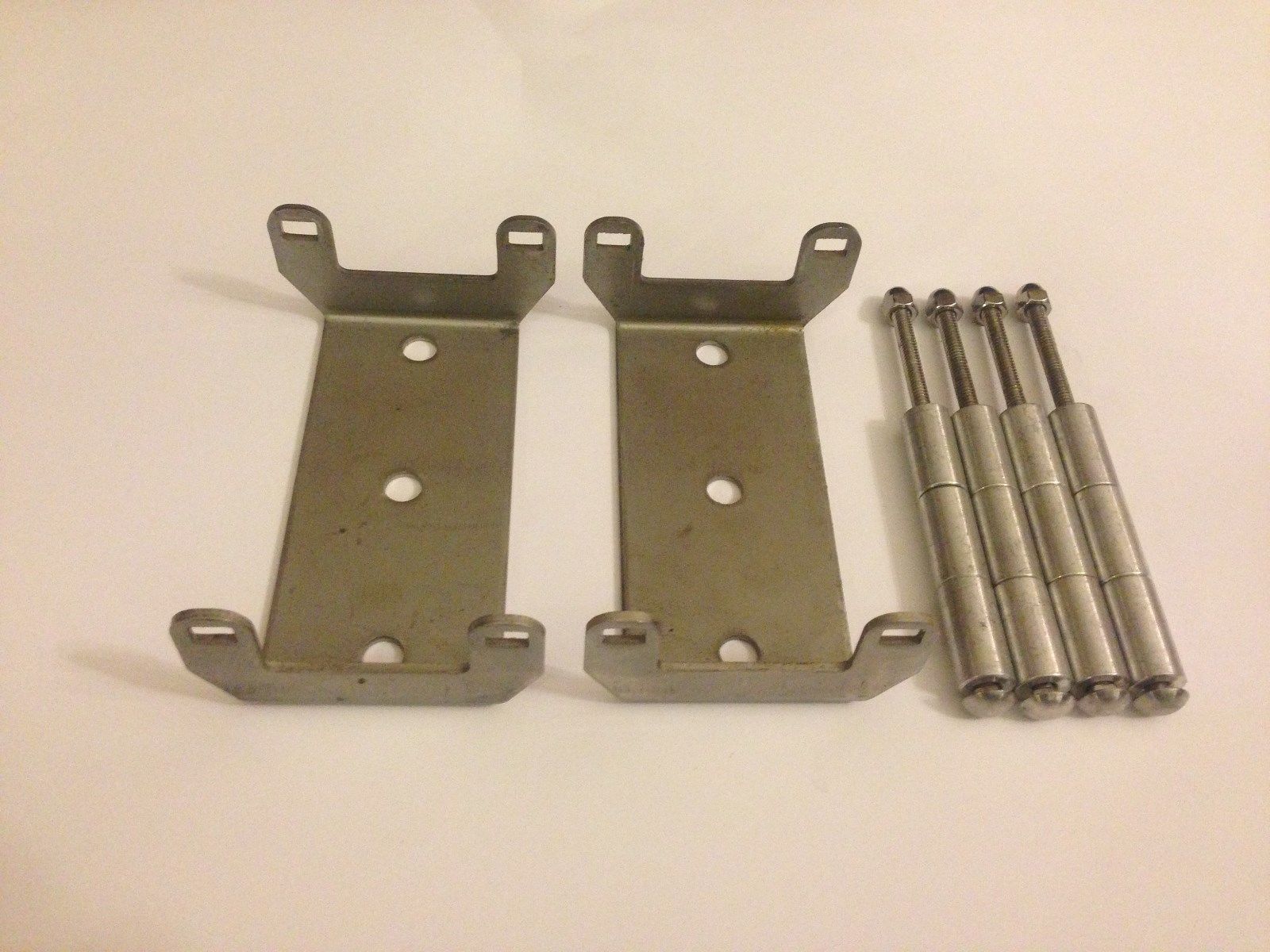

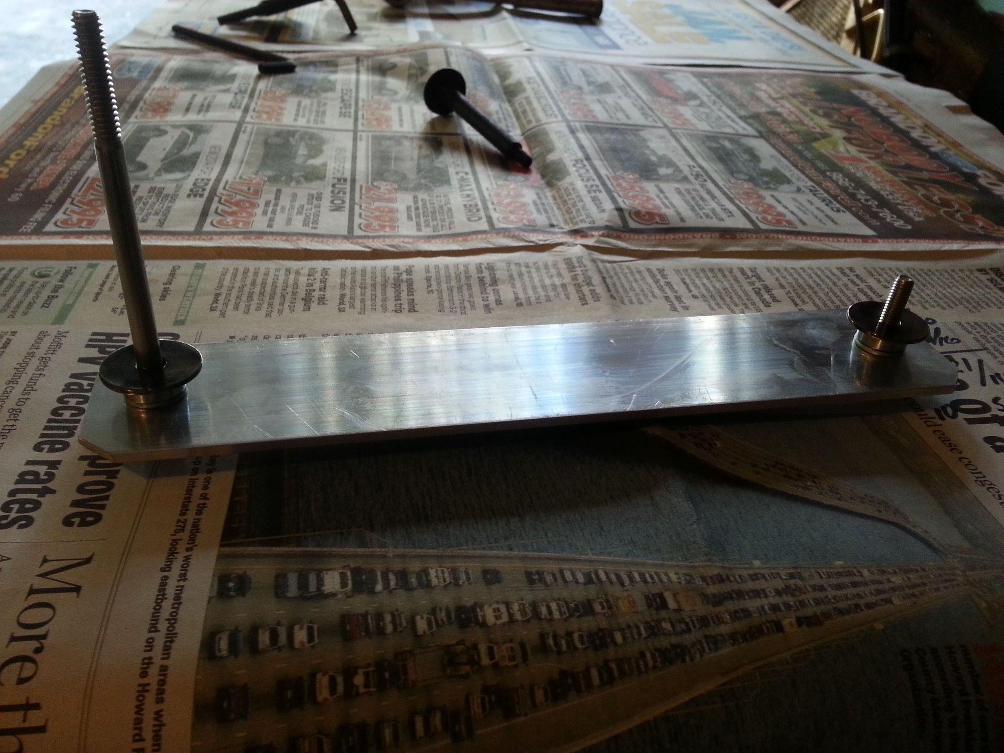

Made my coil mount brackets yesterday.
I ordered these brackets off ebay:
These brackets will mount on top of the brackets I made. They will house the coils. Plan on painting the brackets with black Rustoleum.
I bought 8 LS6 Coils with only 5,000 original miles on them from a forum member in the C5 Section with a 2001 Z06. Got them at a very good price. Once I get everything mocked up I will go ahead and cut my plug wires to length, and I still need to source two LS1 coil harnesses for each bank.
After that it is just mounting the LTCC box in the front of the engine bay near one of the headlight bucket recess areas, and its all plug and play from there.
That is a pretty piece of Aluminum, but the coils that will go on it aren't. Which begs the question: why don't people mount coil-near-plug coils on the frame where you can't see them, rather than on top of the valve cover? That is what I would do.
Yes, mounting the coils on the frame would definitely be cleaner. But, for me, that isn' the route I wanted to take. It would make running and hiding the wires a little harder, it would place the coils even closer to a moisture source, and it would look like Medusa under the hood with wires strewn everywhere.
My plan is to have it look as clean and uniform as possible. All the wiring will be hidden under the stock fuel rail covers. All you will see is maybe an inch or two of wire coming out of the fuel rail covers to power the coils, and then the plug wires running from each coil straight down to each cylinder.
If I ever need to remove the coils, for whatever reason (Maintenance, testing, etc...) It is just two easily accessible bolts and the entire coil assembly will come right out and on to the work bench.
When it is finished, it should have a nice clean race car/industrial look to it. Not that looks matter too much to me, as I never go to car shows or anything. Just like it nice and tidy. I think the coils will look pretty good when they are all cleaned up and sitting on each bracket uniformly with hardly any wires showing.

I dig those coil mounts. What bolts did you use to pull that off? I've got a new opti on order and strongly considering doing the LTCC conversion at the same time.
Thanks. I used stainless allen head bolts from Ace Hardware. The passenger side bolts were all M6X1.00 pitch, and I got them 1/4" longer than the stock bolts. Driver side was similar except one of the bolts was a 1/4x20 thread and about 4" long. I used 1/4" chrome spacers (also from Ace) to elevate the plate off the valve cover. The aluminum is just 2" wide and available at Ace or Home Depot. I cut it to length with a die grinder and beveled the edges. Make sure to get washers the same diameter as the stock bolt head so it seals against the rubber gaskets on the composite valve covers.

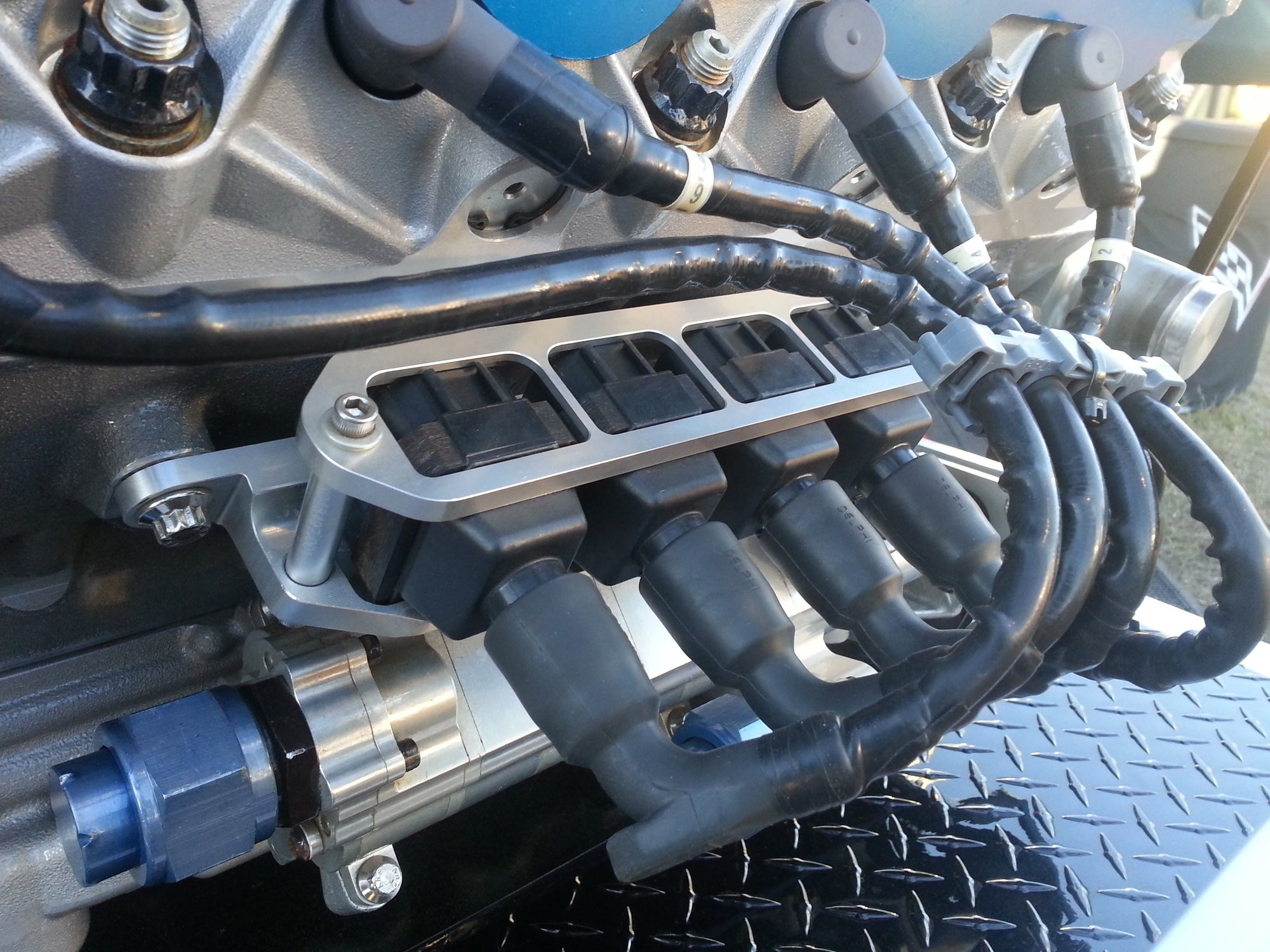

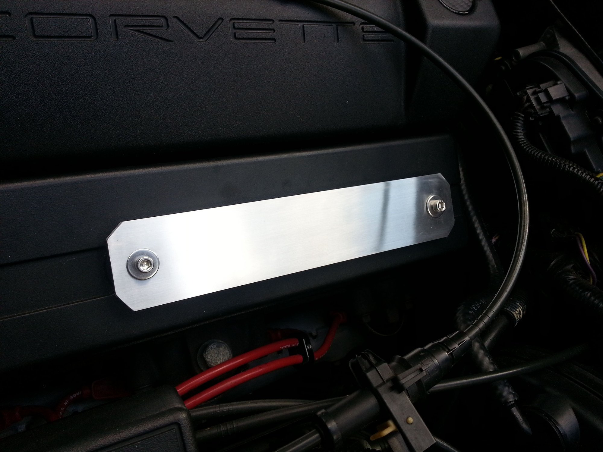

Still waiting on LTCC box, and need to choose which spark plug wires I want to use. Torn between Taylor Spiro Pro or Magnecor's. Sort of leaning toward Magnecor as the Taylor's are sort of hard to snap on and off.
Anyways, coils are mounted....

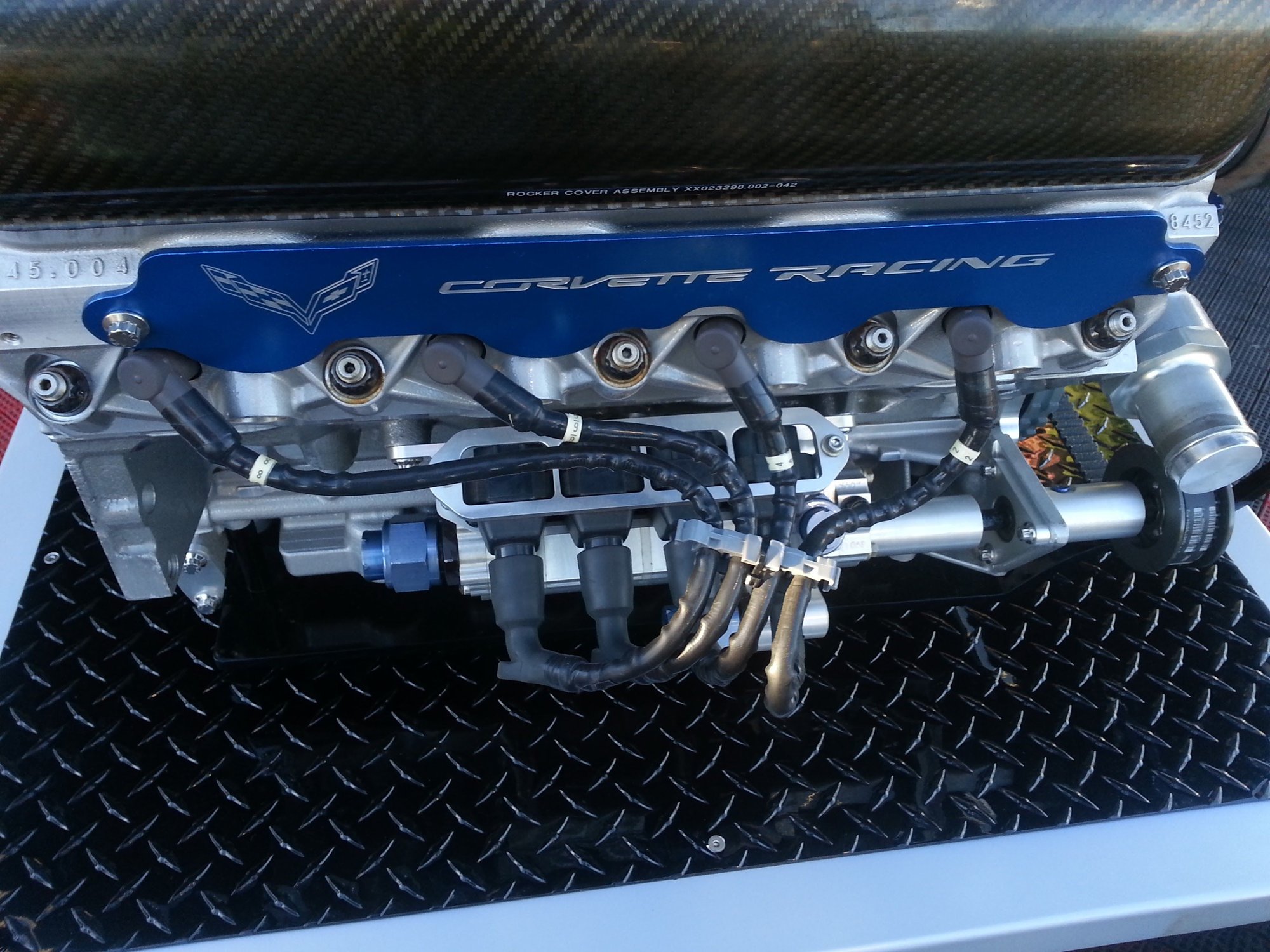

And just for $hits, I was at the Daytona Rolex 24 hours and took a few pics of the C7R Race Engine. Here is how they mount their coils. Neat idea, but horrible plug wire access for a street driven car.
