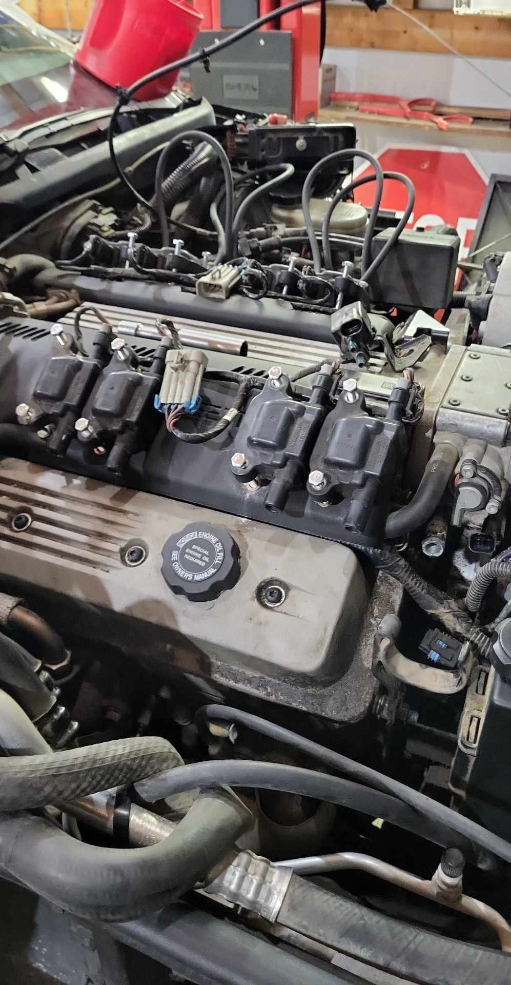

Just picked up a clean 92 vert that had sat in and nice garage covered for 5yrs. Had to shock the fuel pump with a 18v drill battery to get the fuel pump running again. Obviously had a slight misfire when running and so I quickly researched and found the LTCC. As being a former GM tech I was full aware of the opti and the problems surrounding it. And had I not found the LTCC I'm not so positive I would have bought the car. Anyway got it home ordered the LTCC and torn it down. Directions were a little less than desired and my printed version was missing the pages for the 92 corvettes and what to run the white wires to. It was this page that got me straighten out so thanks TorchTarga94! This is where I mounted the coils in the pic was the mock up stage so disregard. Now to clean up under the hood I wonder if the guy was afraid to wash under there with the opti lol.
the long bolts it has since be refined.

I'm glad you found this thread helpful!! My Petris opti and LTCC kit is still going strong 🤙😎
