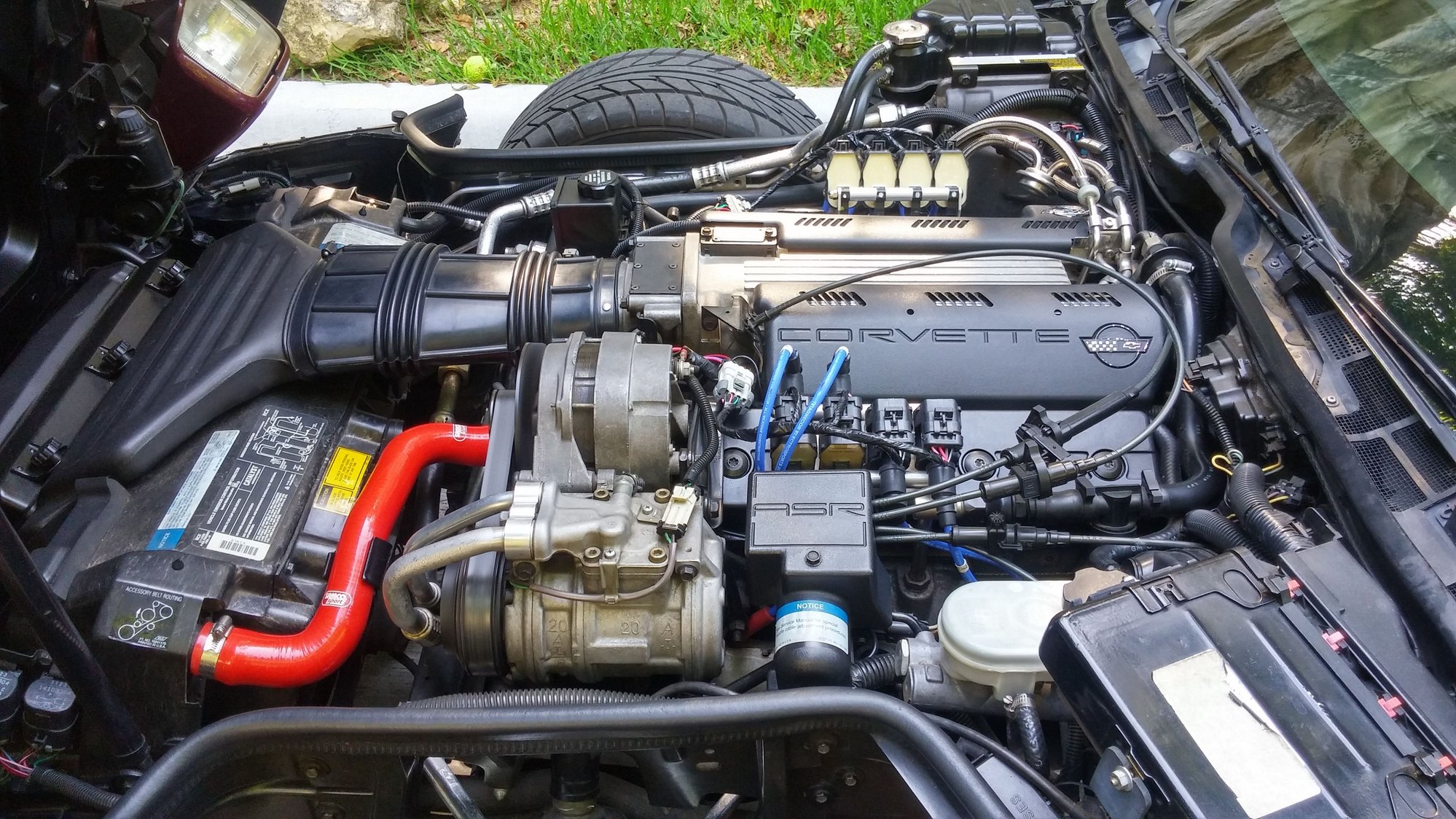

Thank you, there are four wires that I soldered.
LTCC to Factory Wiring
-Two Pink from LTCC to single pink w/black stripe on factory ICM connector.
-White wire with black dot from LTCC to white wire on gray factory coil connector
-Solid white wire from LTCC to solid white wire on factory ICM connector
The two yellow wires are for the activation of the two-step built in adjustable N2O / boost retard. I've heard of people connecting these wires to the window switch to activate it. I didn't delve much into this area as I plan on keeping near stock.

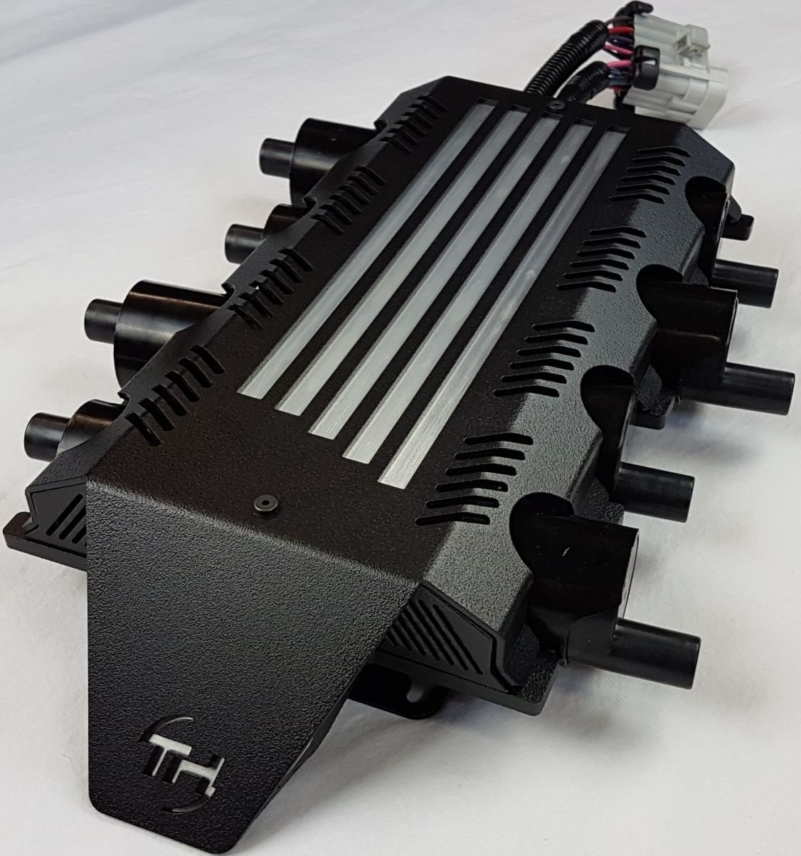

Torquehead has a manifold bracket, but it's pricey
