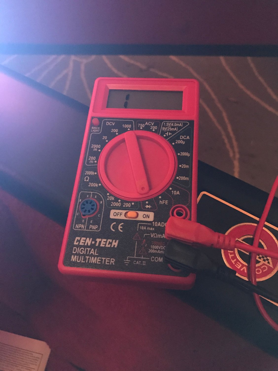

Ok finally got around to buying DVM... not all familiar with these so any help would be great. I think I was able to test the ohms, but can't get the right setting to test the volts coming off the fuse. I purchased the Cen-tech Meter.

Tested all the fuses you mentioned and they are got 12v running.
