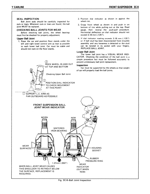

I have a 1986 coupe. Could the ball joints be bad even if car drives straight? What is the best way to check the ball joints??
Thanks...

You could put floor jack under lower a arm lift tire 2" off floor, put long bar under tire and have someone watch lower ball joint while you try to move tire up and inward, while on jack grab top of tire and move in and out while useing bar under tire have someone watch upper ball joint or have alignment shop check them.

Also check the grease fitting on the lower ball joint, for stocks this indicates when wear has gotten far enough it should be replaced.
Might be able to squeeze under the car and see, but I would jack and remove front wheels.
