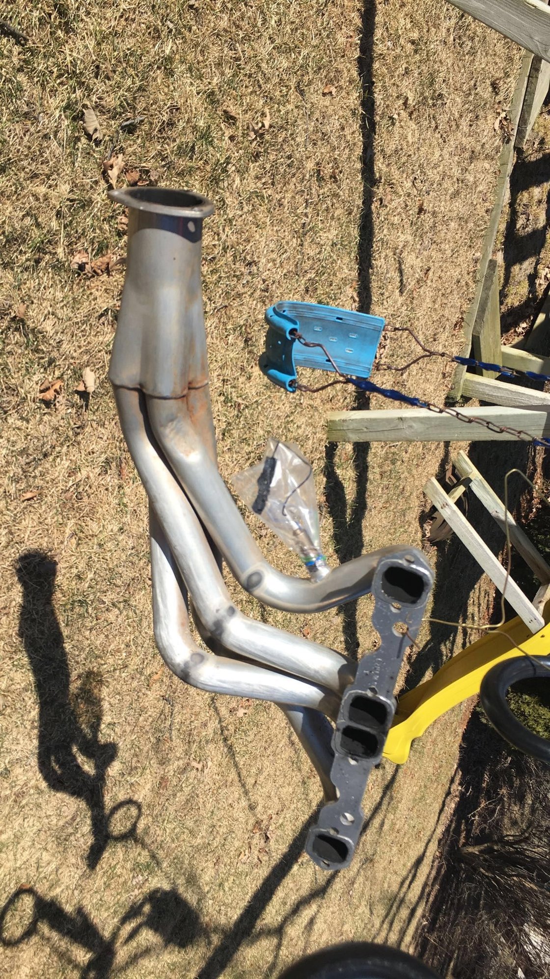

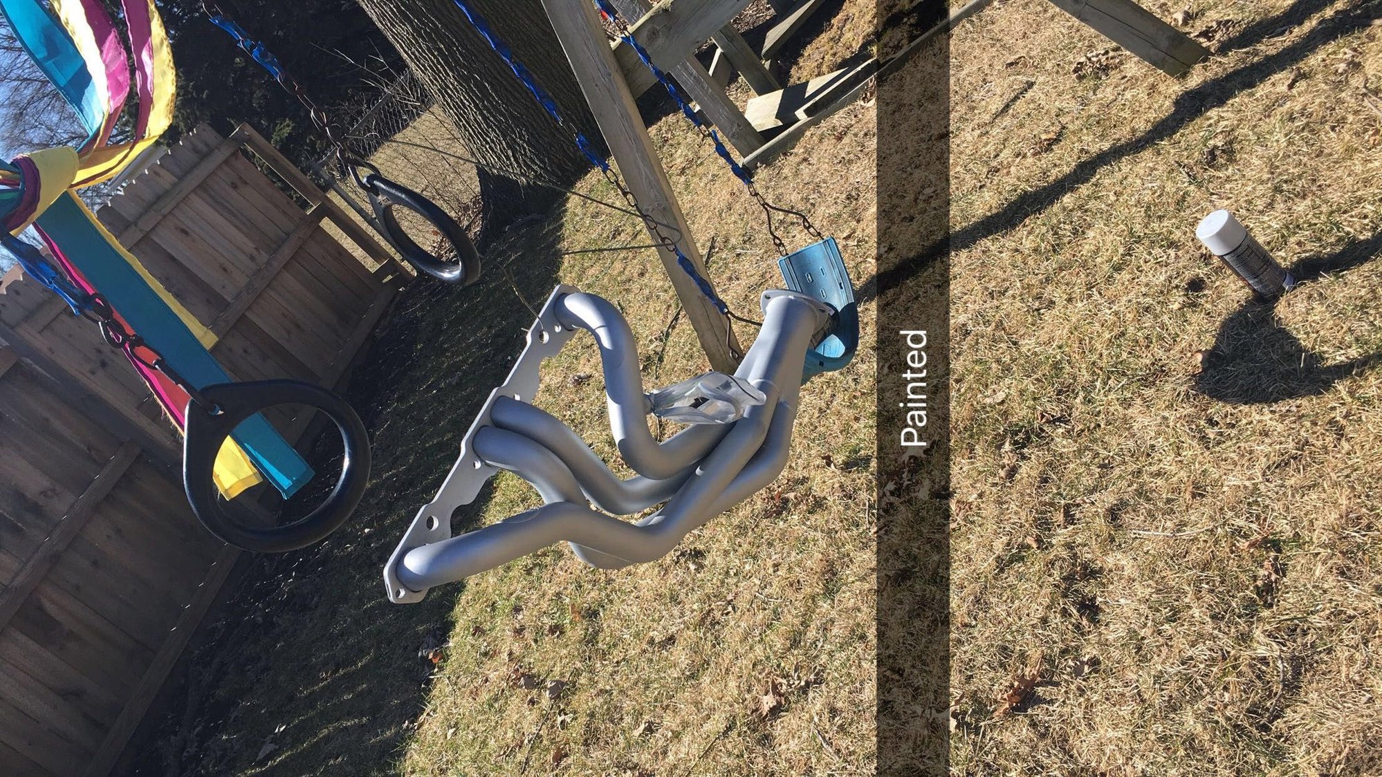

also I thought you may find these interesting, I primed and painted the once coated headers I received from another forum member, I scuffed, degreased, painted and heat treated them!
Also

They were more rusted than they look trust me
Your wife is gonna beat your *** for using the kids swing for a parts holder, lol. Be sure to use antiseeze when putting it back together.

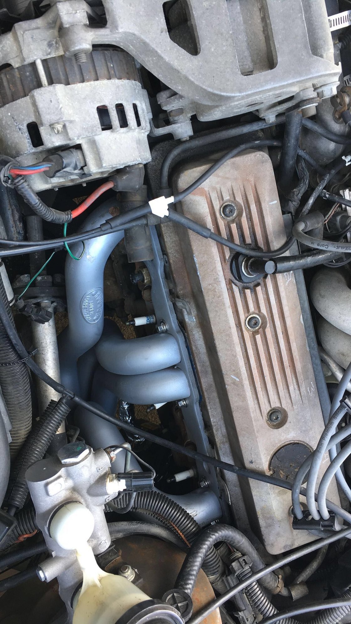

After a bit of swearing one side is on! Gasket sat well with what I hope is no overhang. I now realize I forgot to use anti seize on the header bolts... so I'm going to take them out one by one and apply anti seize... but this side really isn't too bad. I've got a mini starter on the way from another member, and then I'll get to work on the drivers side

Primarly finished up the header install today!
passanger side I would say you will suffer....
i became unlucky as always and broke the dipstick off in the block, but I also was able to remove the rest without dropping the pan so be careful there, once you have that removed I replaced the starter with a mini starter "after header was in place" which I added some thermos type tap too just for alittle extra fun.
Then came the number 8 bolt. I installed one bolt only loosely which held the header in place, then I was able to install the number 8 bolt by hand, so once that was done and I had it in place, I used a very interesting tool. I untilized a breaker bar with a "3/8 hook" type socket, which made tightening it up very easy. Now my headers are on!
once everything is installed I've been going over the work and doing visual inspections, taping wires back where need be and adding some of those heat shields too the spark plug wires, I haven't gotten a new dipstick yet it's on the way, HOPEFULLY but doubtfully it goes in well, and I'll CHANGE THE OIL and fire it up! A lot of junk may have fallen in well removing the dipstick.
