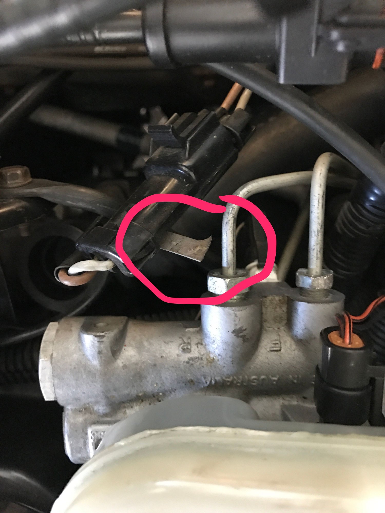

Does anyone know where this metal piece on the connector for the ASR is supposed to go? It's been like that since I got the car

Sorry.... the picture of the wires are what I found when I removed the plastic loom. The second picture is what it looked like when I cleaned all the grease and grim off the wires. I've since cut and soldered them.
Thenpicture re of the connector is where it connects to the ASR under the hood. There is a piece of metal coming off the plug that I am trying to figure out where it goes or if it is broken off something else

Originally Posted by offroadjim
The picture re of the connector is where it connects to the ASR under the hood. There is a piece of metal coming off the plug that I am trying to figure out where it goes or if it is broken off something else
That is my guess; that the metal tab is a mounting bracket. I just took at look at my 91 and I can't see anything that it resembles.
