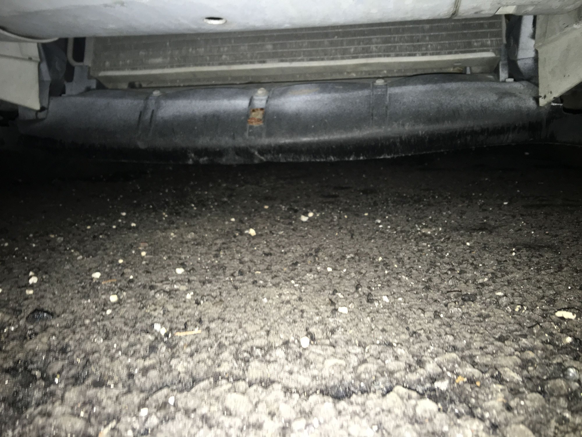

Does not appear to be any damage to the air dam, anyone know the clearance needed there for optimal airflow to be certain? Otherwise air dam does not appear to be damaged in a way that would block flow. Lemme get a picture

Apologies for the poor light quality, nighttime here and used my phone light

Your front condenser looks clean but there is a space behind the condenser and the radiator,,,,,THAT is where the crap gets stuck.

Ok. Do I need to remove the air dam to check that out? It's probably really obvious to check but I don't see it...

No need for a dam photo.

You may have to remove the fan shroud. Looks harder than it is. You are "In and out" in about an hour.
But first, take a flashlight and look between the cracks in the shroud to see between the condenser and radiator. It you don't see anything then you are good.
I've seen the front condensors clean as a whistle, and then the "in between" space almost half full with leaves, plastic bags, housing insulation, cigarette butts and a larger slurpee paper cup. Once cleaned out the car cooled nicely.

Should be able to see it from the side looking between the ac condenser and radiator. My 94 had a huge matt of dirt and grass covering about a 3rd of the radiator.
