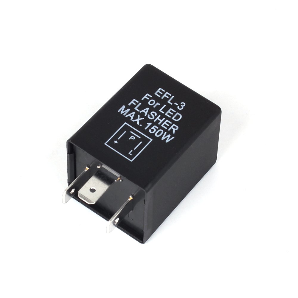

Is it a mechanical or an electronic flasher. If you are running LED taillights or blubs you need an electronic flasher for them to work properly

Originally Posted by SLBENFICA63
It is led tail lights and it is an electronic flasher that i put in it came in the package along with the tail lights
Try another electronic flasher that one is probably bad. Here is what I used

Goldcylon i really appreciate it you saved my day i called a few parts stores here in RI and i ended up getting one not the one you showed me a picture of anyway if anyone has the same problem as i had where nthe flasher would keep clicking as soon as i woul turn the ignition and even when i started the car it would keep clicking weird anyway thanks a bunch from (GOLDCYLON) they should get one from Auto Zone their part# EL-12 its one of those see through flashers you can actually see all the guts in the inside i put it in today and bang works like a charm
