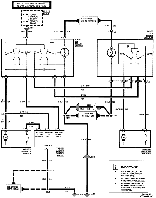

Hope you can blow this up enough to be of some use. From my 96 FSM.
Made up a little saying to help me remember how the switch works: GROUND on Brown, the window goes Down. GROUND on Blue, it goes UP for you.

Messed around with the window switch today. Took the panel off and found the connector that runs to the motor, brown, blue and black. When the switch isn't touched both the blue and brown wires have power, and depending on how you move the switch it turns off power to each wire, Since the seems to be working, then it must be the motor is bad?
