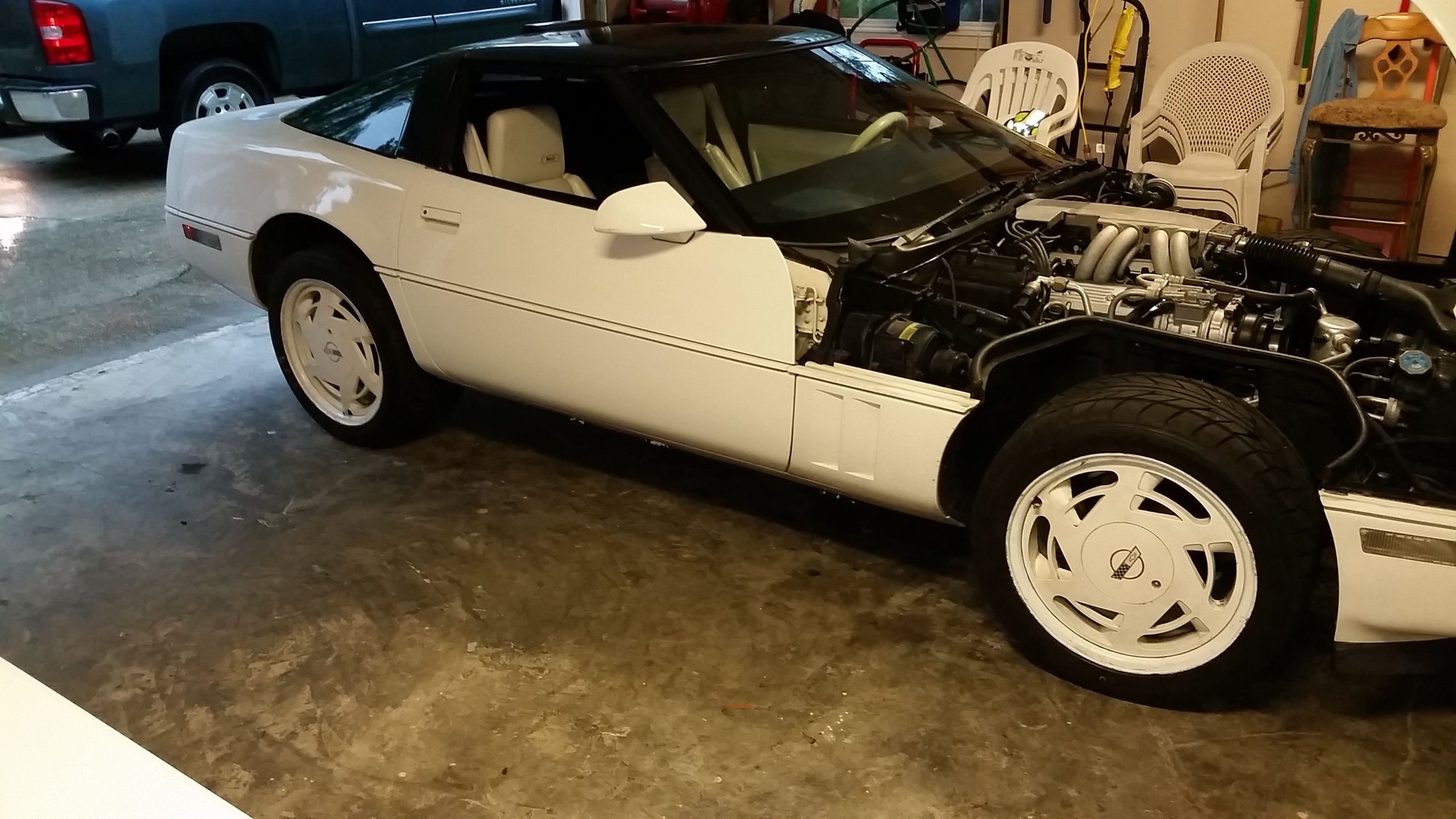

OK so the PO strikes again. Which wheels are right, front or back. From looking at other pictures I am thinking the backs are correct but want to make sure before I pay to have them remounted.

Maybe all you have to do is to swap wheels from side to side. The wheels will be marked on the inside with something like "Left" and "Right". If the tires are marked as directional, they will have to be removed from the front wheels and re-installed correctly. Look for an arrow or Left or Right side.
The rear wheels are on correctly.

That is what I thought. The Tires are directional, Nitto 555, so I will have to have them remounted. I bought the car in January and just noticed this.

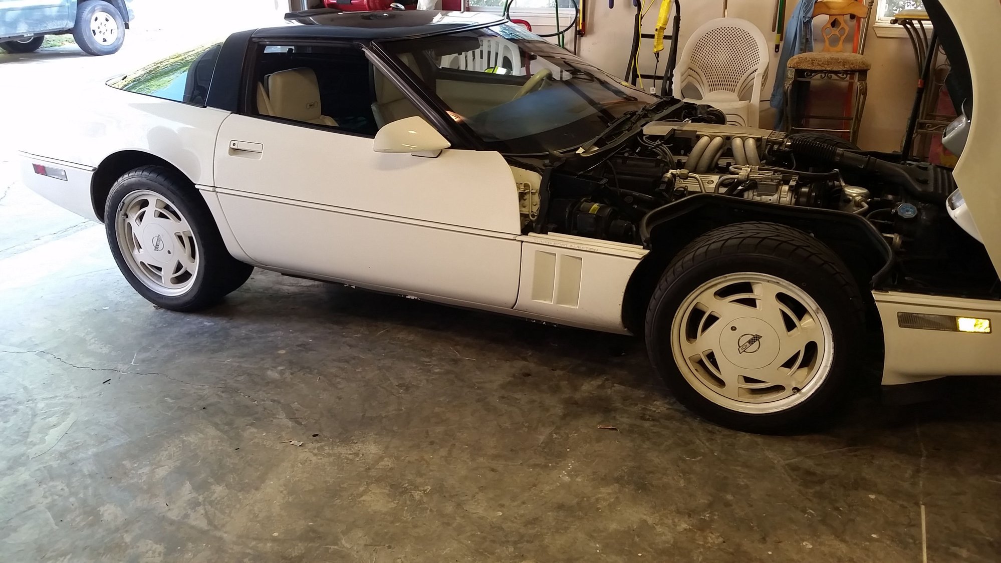

Got them remounted today. Looks much better.
