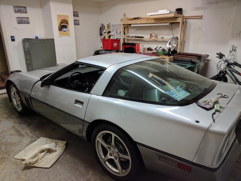

Hello all,
I picked up an auto 84 silver two-tone about a month ago. I've already fixed a couple things so I could pass emissions (TPS, plugs/wires, oil) and drive in the rain without crashing (wipers, headlights). I've been able to dd it for 3-4 weeks now and it's been great and I'm excited to continue bringing it back to life. The issue is I'm also trying to show my wife that it is not a huge money pit.
These two are very difficult to reconcile.
Right now, the car NEEDS nothing. I can drive it to work tomorrow without stalling or crashing. Work is only four miles away so that isn't a huge accomplishment. The car does WANT lots of things though and that is what I am posting about. I need some help prioritizing what I should buy this month and what can wait. I can probably only do one bullet a month ( I know that brakes don't cost the same as tires, but still). I'm comfortable doing all the work myself barring tires and maybe the exhaust. Minor fixes 1 are things I can buy at once from Central whereas Minor fixes 2 are things that could cost nothing or things that could cost a lot, depending on what I find while I'm inside. Same with funny engine issue.
Without further ado, the short list:
  • Brakes: needs all four rotors and rear pads (I replaced the fronts Saturday). Car stops, just sounds bad doing it.
  • Tires: Age cracked.
  • Seats: Driver's seat frame is cracked and passenger seat foam is ruined. Covers are cracked too. Aftermarket is fine.
  • Exhaust: Terrible drone between 1200-1600 rpm. I.E. the operating range of this car. It looks fairly rusted from my brief glimpses.
  • Minor fixes 1: Windlace, front t-top bolt replacement, driver door handle
  • Minor fixes 2: Intermittent Horn, loose exterior mirrors, missing cooling sensor (between plugs 8 & 6), speakers (fronts), AC (not cold).
  • Funny engine thing: If I floor it then come to stop too quick (not quantifiable at this time), the car will "stall". By stall I mean it will idle at 5,4,300 then die. It always starts right back up. If I don't drive like an idiot I have no issues.
So what do you folks think I should work on next?
