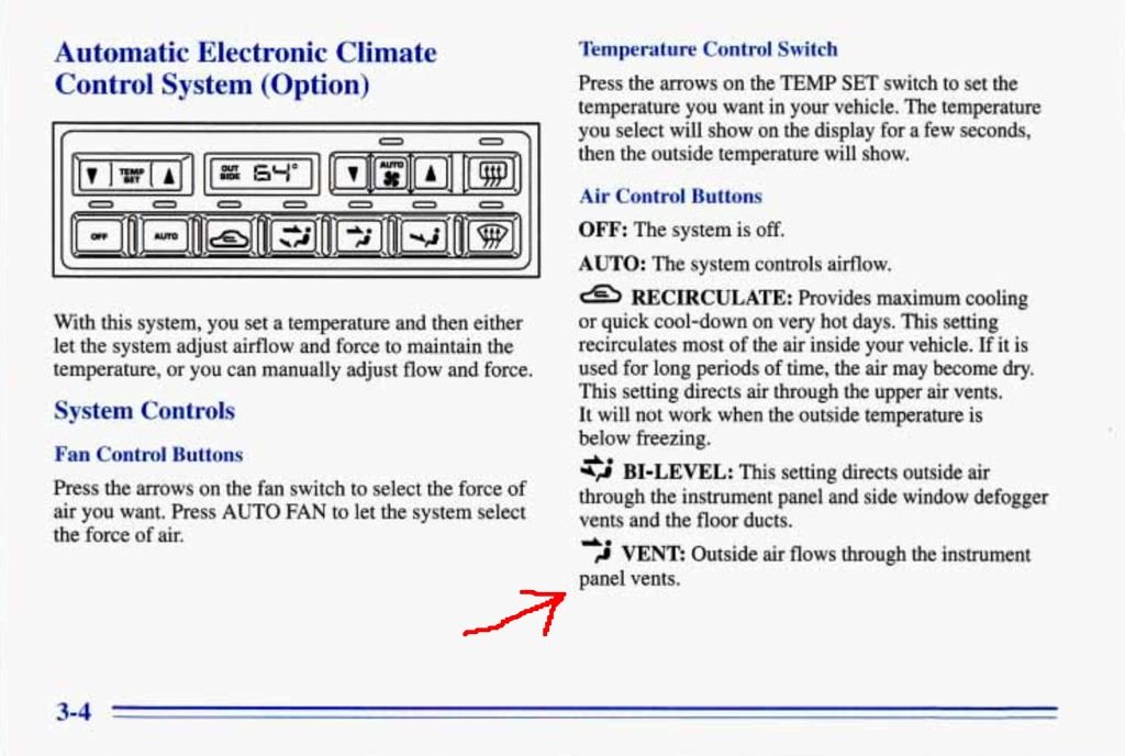

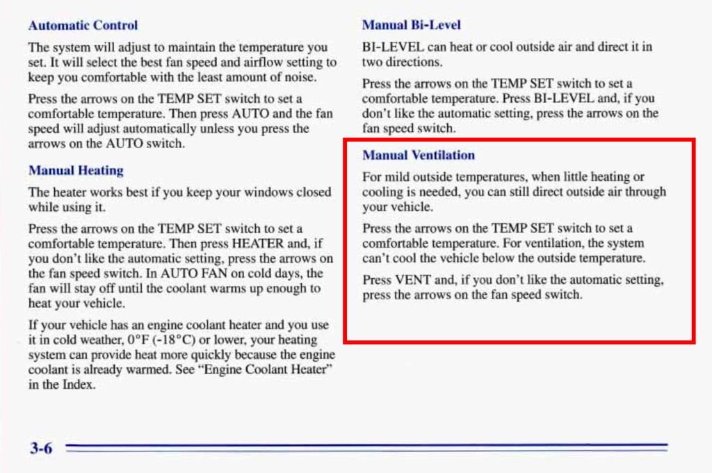

I think I already know the answer - but just in case - does my '94 have a fresh air "vent" setting for those cool evenings when AC is not needed in the summer? Seems like it's AC or heat all the time with my climate control set up.

Yes, there are buttons on your control panel that shows air flow patterns.
Pick the one that shows air coming from the vent and adjust the temp and fan accordingly.

I have wandering the same thing... I thought of it like this; does the compressor come on in any position other than auto, recirculate and defrost?

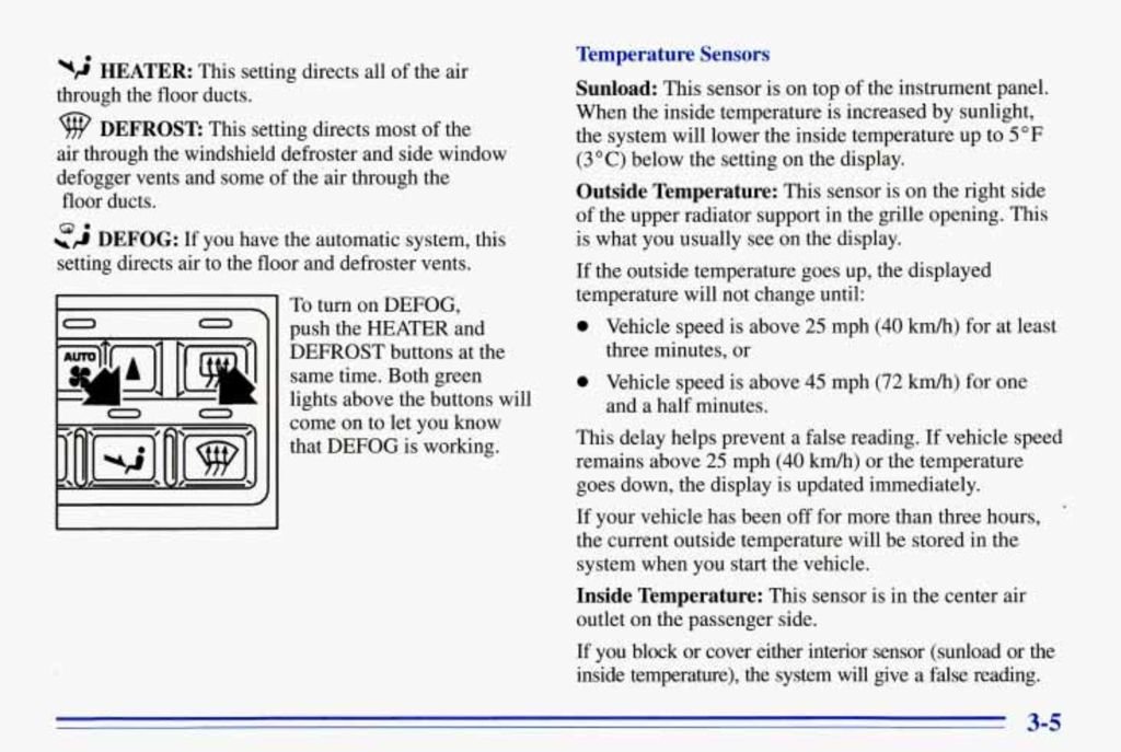

The compressor could come on in any position other than "vent".
