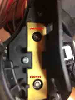

I had some issues with my horn (also a 92) working only when I pressed the button a certain way. When I had the wheel apart for a turn signal issue, I found some corrosion on the contacts. There pretty easy to clean.
