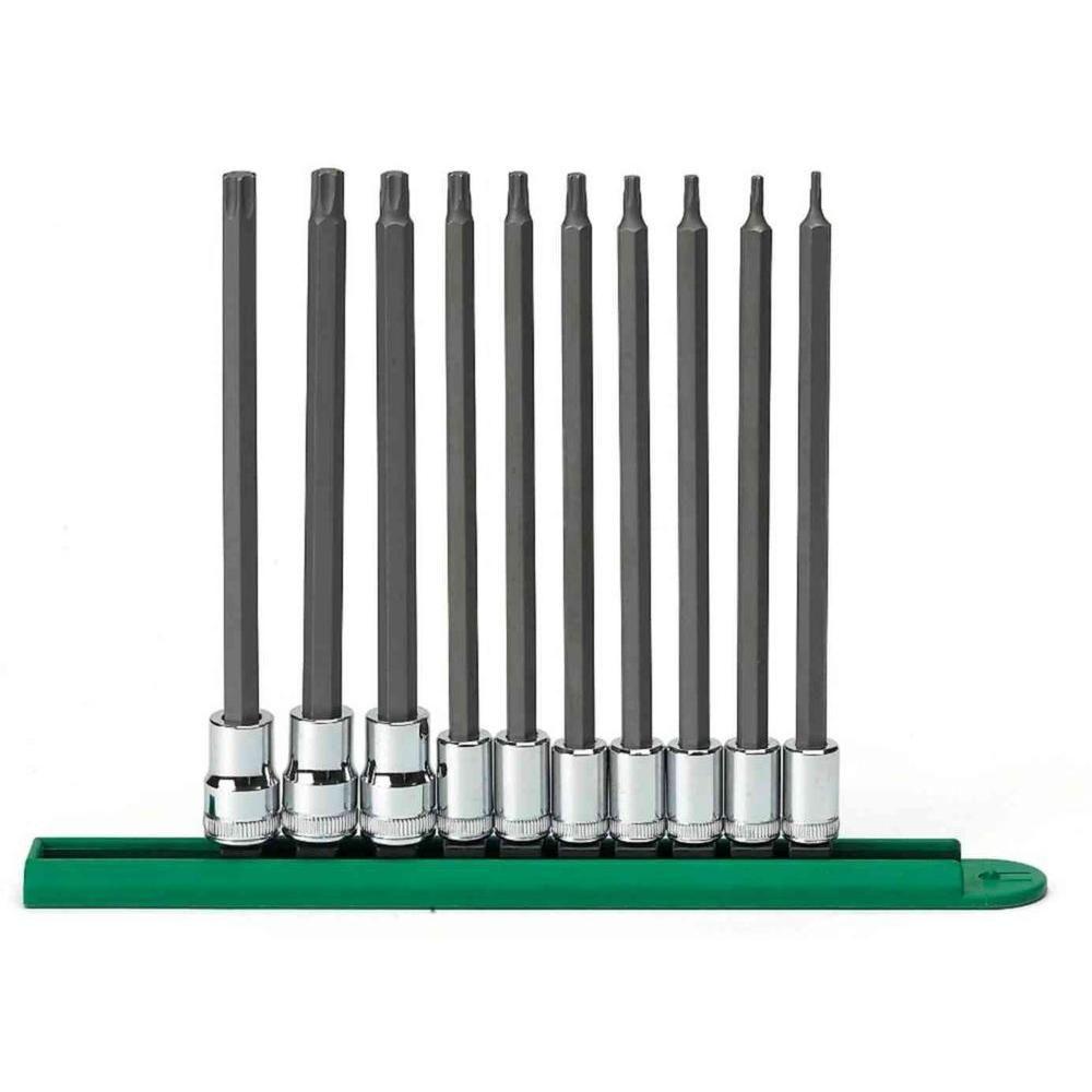

I'm having trouble getting out the one between the back 2 runner pipes. The one the valve cover makes a pain in the a**. Any suggestions? it might actually be stripped from all my attempts but I've thought a lot of these torx bolts were stripped and came out no problem. do I need to get a T40 Allen wrench style to get to it?
I use one of these and some extensions for all of the bolts:
This might be crazy, but after almost stripping one of the bolt heads I marked the head of my torx bit with nail polish so I could determine when it was fully seated - if I don't see bright green, I'm good to turn!
