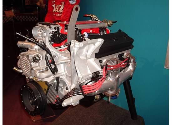

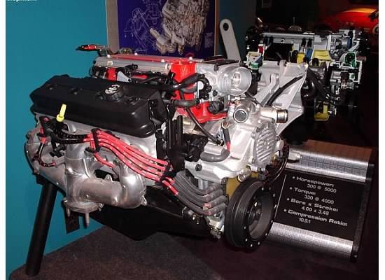

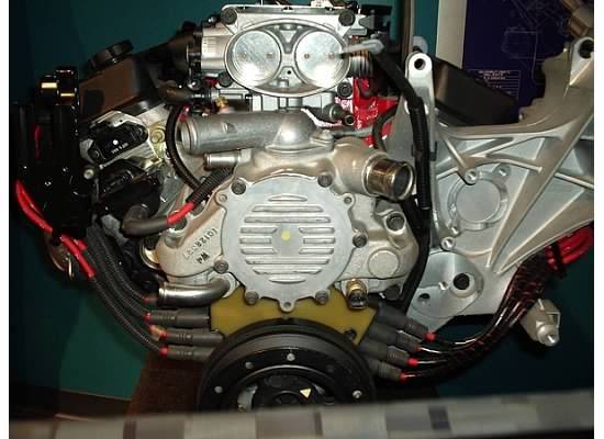

On one of my visits to the NCM I took pics of the LT4 engine on display. I hope this helps visualize placement for you.
Have you tried posting a request in the Forum's C4 Parts For Sale/Wanted section?

As a matter of fact, I used your pictures. They were online in a search. They were MOST helpful since I didn't know what I was looking for. Thanks!!
